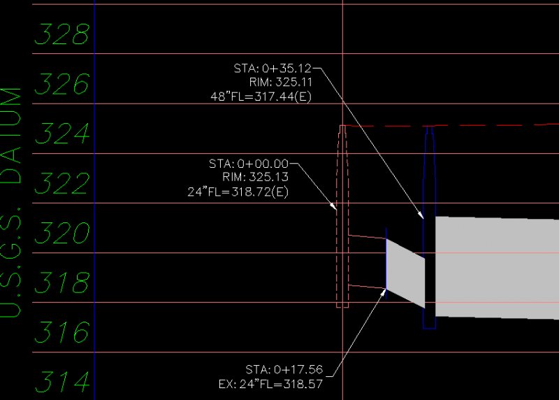

So I've labeled pipes and structures in profile view and can't figure out how to get the leader to connect to the top of the manhole structure.
For structures, it only point to the middle and for pipes, it only allows you to move the leader along the centerline of the pipe.
Is there any way to change this?
My best conclusion is to just turn off the leader in the style and just manually draw one, like I did in the bottom label in the picture below.

The labels are not multileaders. They are dynamic and a specific label for the Pipe Network.

I've been all through the Label Style Editor and the option for label attachment is where the label attaches to the leader, NOT where the leader attaches to the object.

Thanks, but that is for where the leader attaches to the text, NOT attachment to the structure.

Well, now that I've drawn a profile in C3D2013, it's doing the same thing. I found a site that suggested dragging the label to somewhere close to the top of the structure--which will anchor the end of the leader to a point on top of the structure rather than the center--and then pinning the label there. You're supposed to be able to move the label from there and get something reasonable. Except that that doesn't always work.
And while I'm hijacking this thread, some of those dragged labels will shift themselves to 0,0 when I reopen the drawing, and some of those dragged labels don't print, even though they appear in the print preview. Tell me again why we pay thou$ands for this poorly thought out, bug-laden, unsupported software.
