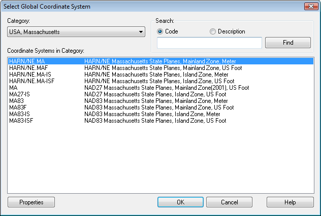

It's not so much a drawing area issue as it is datum issue-- some of the GIS layers published for the state of MA don't work well if you try inserting them just at 0,0-- e.g. the endangered species stuff is one layer for the whole state, and inserting everything at 0,0 doesn't line stuff up properly.
With Land Desktop use the _ADESETCRDSYS command, then set the code for the datum you need. Notice there is a number of them as my attachment shows (from version 2011)
[ATTACH=CONFIG]34524[/ATTACH]
You, sir, are a lifesaver. That's exactly what I was looking for. Many thanks.
