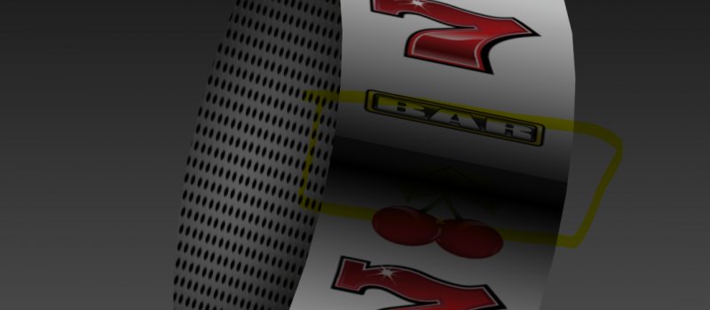

@Cad64 or anyone..?
The tutorial was a complete success except this..
Do you know what causes this?
i have isolated this to a viewport issue and not a material issue.
this issue disappears once a light is created that shines on that area.
i would like to not have it at all.
This has to do with viewport lighting or something and does not pose a problem if proper lights are created.:glare:

Is that where the image tiles? If you post the model, and the material, I'll take a look, but if it only appears in the viewport, and not in the render, I wouldn't worry about it.
