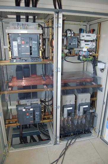

BIIST Posted April 27, 2012 Posted April 27, 2012 hey all i was wondering if there is any good software for electrical engineer that can design and edit electrical shemes and espcilally could design 3D control panel (including all electrical parts such as contactor. circuit breaker ...) i tried autocad ...works good for electrical shemes but 3D part isn't his good point apparently, the project becomes too slow and difficult to control (for exemple can't easly rotate the model) because of the large amount of stuff i use (circuit breaker . contactor.etc...)) i'am also looking for some free electrical Distribution's 3D model thanks in advance Quote
ReMark Posted April 27, 2012 Posted April 27, 2012 Have you looked at AutoCAD Electrical? Some manufacturer's make 2D and 3D blocks of their equipment/components available for download in DXF and/or DWG file types. What are the specs on your computer? Quote
BIIST Posted April 27, 2012 Author Posted April 27, 2012 thanks for the answer buddy !! hmmm, i didn't know that electrical can design 3D control panel!!! anyway i tried it some years ago, i found it complex a little, i think i prefer autocad pro +some lisp =, it's a quick way to design electrical shemes ...however it's not the best solution to design 3D model ...right? what about autocad ecscad ? could it be a solution for my problem ...or should i use solidworks? What are the specs on your computer? i didn't understand what you mean anyway, i work on somethings like that thanks in advance Quote
ReMark Posted April 27, 2012 Posted April 27, 2012 You design electrical panels but don't know what I mean regarding the specs of your computer? Interesting. You mentioned some difficultly working with objects in 3D which I took to mean your system is slow. So, what do you have for a CPU? How much RAM is installed? What are you using for a graphics card and how much video RAM is onboard? Are you using a normal platter drive or a SSD? If you are using a normal platter drive what are its specs? I'm familiar with the types of panels shown above. I'm also familiar with PLC design/layout. Quote

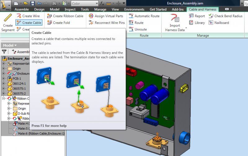

JD Mather Posted April 27, 2012 Posted April 27, 2012 Autodesk Inventor (perhaps with Routed Systems). If using AutoCAD you should be using xrefs. http://wikihelp.autodesk.com/Inventor/enu/2012/Help/2144-Tutorial2144/2914-Cable_an2914 of course the part shown in the routed systems tutorials were created in Inventor. Here is an image of the interface. Quote
BIIST Posted April 27, 2012 Author Posted April 27, 2012 Autodesk Inventor (perhaps with Routed Systems).If using AutoCAD you should be using xrefs. http://wikihelp.autodesk.com/Inventor/enu/2012/Help/2144-Tutorial2144/2914-Cable_an2914 of course the part shown in the routed systems tutorials were created inInventor. Thanks forthe reply JD, I appreciate it…however I must say using xref isn’t the bestsolution for me, I already tried it but unfortunately the laptop is slow enough … plus most of the bandwidth in the network goes to another applications(mostly for purchasing department ) so loading xref always take a hell of time L Btw, whatabout solid works? Your computer specs are woefully inadequate, across theboard, for doing any serious 3D work. My advice: Upgrade to a better computer system then move on from there. I will talkwith my boss Until then,can you please explain your method todraw 3D model I mean: -software ( -tools -lisp Every thingsyou can And ifpossible a little DWX’s example Thanks again Quote
