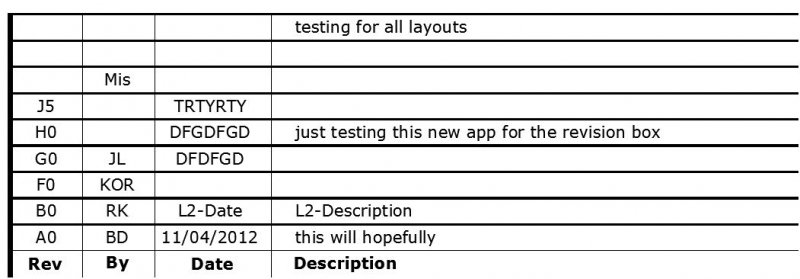

The revision box looks like this.
I am wondering how to control the number of lines to be shown. I was thinking of using a layer for each line and control it that way but I was wondering if it can be detected what line is empty and display to the line before it. So an automatic way of controlling the lines.

Can anyone help even with the part about the block name not being picked up correctly?
Thanks.
Cant open your file woodman78. I'm getting "drawing file is not valid".
Regarding Blcok name, How may Rev_Box block are you expecting to find on your drawing?
The way its written now.. it checks ALL blocks with attributes [iNSERT/66]
Then it process the selection till you find "REV_BLK", but in your case "*U54" which you already figured that its not always the case
So. if it is indeed 1 bllock. Depending on your current setup
 (setq ss1 (ssget "X" '((0 . "INSERT")(66 . 1)[color=blue][b](2 . "REV-BOX,`*U*")[/b][/color])))
That snippet will select ALL blocks with attributes that meet the condition i.e. "REV-BOX" and Anonymnous Block names (if any) . You can however add another filter
 (setq ss1 (ssget "X" '((0 . "INSERT")(66 . 1)(2 . "REV-BOX,`*U*")[color=blue][b](410 . "MODEL")[/b][/color])))
Selects REV-BOX (or Anonymous DB names) exclusively on Model Space or
 (setq ss1 (ssget "X" [color=blue][b](list[/b][/color] [b][color=blue]'[/color][/b](0 . "INSERT")[b][color=blue]'[/color][/b](66 . 1)[color=blue][b]'[/b][/color](2 . "REV-BOX,`*U*")[color=blue][b](cons 410  (getvar 'Ctab))))[/b][/color])
Selects REV-BOX (or Anonymous DB names) on current layout tab
So then:
(if (setq ss1 (ssget "X" '((0 . "INSERT")(66 . 1)(2 . "REV-BOX,`*U*")))) ;<-- again depending on your current setup
     (setq count 0  emax  (sslength ss1))
     (while (< count emax)
            (setq en   (ssname ss1 count) ed (entget en))
            (if [b][color=blue](eq  (strcase (vla-get-effectivename[/color][/b]
[b][color=blue]                         (vlax-ename->vla-object en))) "REV-BOX")[/color][/b]
                    (setq count emax found T)
    (setq count (1+ count))
As for the DCL. i might need some time to disect your DCL . ;)

pBe, Thanks for your help. I got the lisp to recognise the block using your first method. It turns out the name is case sensitive.
On your option to select the block on the current tab how it one select the blocks on all tabs?
btraemoore, I like that. I could setup my block and drop them in as needed. How could I count? By taking the first blank attribute and setpping back one?

I re-read your first post this morning woodman, It appears that you indeed have more than one Rev box
Apply to Current Layout ONLY Apply to ALL layouts which tells me there are mroe than 1 layout tab at one time.
Would you rather "grey out" the blank Rev lines? (mode_tile ...) and add an option for New / Edit . soemthing like this.
Detecting the current rev is not that hard really.

I was thinking of writing a routine that will show only ACTIVE rev lines + 1 Blank depending on the last current Rev number instead of Dynamic block with visibilty. What do you think?
EDIT:
Question for you, if you select ALL layouts, does that mean all Rev-Box rev nos/by/dat/description all the same for all layout tabs? That will complicate things if they're not.
Also, 1 Title Block per layout tab?
