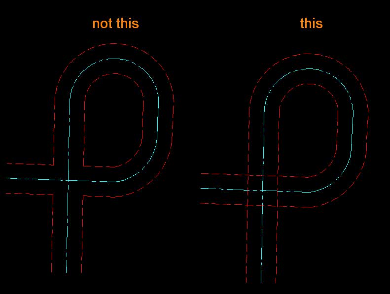

Is there any way to turn off the automatic trim "feature" when offsetting polylines?
I need to draw centerline & tire paths for trucks in a parking area, my problem is any time they cross themselves they get trimmed. These are complex paths with arcs & lines trying to achieve a smooth path. I lay down the centerline & I should be able to simply offset to get the tire path. What I wind up with looks more like a multiline wall cleanup than crossing paths.

Thanks for the comment but I simplified the image to clarify, while the front tires & the back tires won't run "parallel" Physics says that each pair of tires must run parallel.

I use a lisp routine "turn" that will draw the back axle centerline track starting with a polyline centerline track for the front axle. Then I offset to get each tire track. It should be close. I just fun into problems if the truck crosses over its own path.
The auto trim makes something that should be easy into a complex redraw operation. especially since the "turn" lisp routine makes very segmented polylines.
