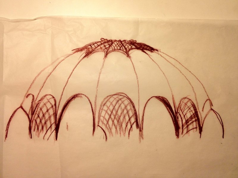

It is supposed to be an outdoors performance space that is covered by this shell like structure. It's composed of concrete ribs meeting at a point but only in a semicircular shape. The webbing inbetween the ribs have catenary curved arched openings with some of those openings having a lattice structure inside. The top of this hemispheric dome is supposed to be a sort of skylight with mullion work and glass. Here are some sketches of what I had in mind:

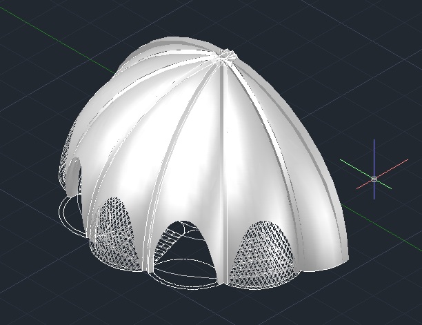

Now I started to model it in 3D Cad since that's what I know best but this is a very complicated curved structure where curves dont just happen on one axis but 2 or 3. I was able to somewhat create the ribs but i have no clue how to actually create the shell webbing in between and then cut out the catenary curved arches with lattice work or the skylight component for that matter.
If anyone could help me out on this i'd really appreciate it! If it is easier to do in 3ds max, then I am able to do that too, but I just need some guidance. I've attatched my attempt of this model with the corresponding floorplan.

If all you want is a conceptual model and you want to do it in AutoCAD, I’d use surfaces to define the complex geometry. I’ve attached an AutoCAD file with an image underlay that will hopefully give you a starting point.
Isolate layer EDGE1 and you’ll see the geometry I used to create SURF1. The vertically curved arcs are extracted from your ribs using the extract edges tool. The horizontally curved arc is copied directly from your floor plan.
To create SURF1 I lofted to two vertically curved arcs and used the guide option. I selected the horizontally curved arc as the guide. Then I brought in your elevation image as an image underlay to get a rough idea of the size of the catenary opening and quickly created a profile. Then I 3d rotated the profile to be vertical and moved it outside of the geometry.
To create SURF2 I extruded the profile through SURF1. Then I trimmed SURF1 using SURF2 as the trimming surface to create the surface with the opening that’s copied to the side of the original geometry.
I tried to use thicken to create a solid shell that was the thickness of your floor plan wall depth but it wouldn’t work due to self intersections. I tried to offset the surface the same distance and that failed too.
You’ll probably have to repeat the process that I used to create the outer surface of the shell in order to create the inner surface of the shell. Then you can patch these surfaces together and hopefully use the sculpt command to convert the shell into a solid.

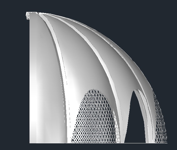

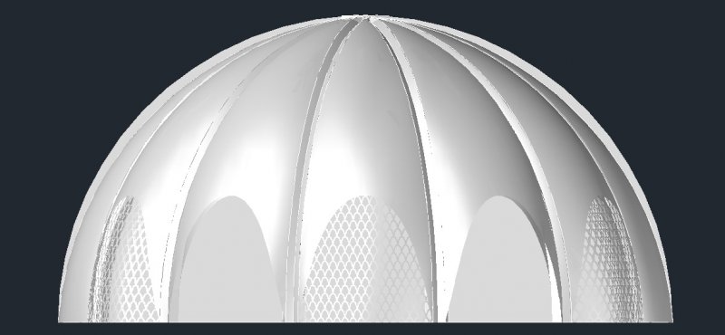

Well I had my final review yesterday so as you can imagine, I was extremely busy the last couple of days, but at least now im done! As for the model, I followed your instructions 3D generator and was able to create the surfaces of the webbing but had no luck in converting it into a solid so i had to just leave it like that. I was also able to create my lattice by extruding them and subtracting just like the arches. Here are some pics of the final thing:
My original idea for the performance space also included the glasswork at the top but I simply ran out of time to try to figure that out. Of course if I had more time I would keep working on it. Regardless of this, the rest of my project was great. The rest of my building was already in 3D, this was just sort of the icing on the cake. My reviewers really loved my project and only had great things to say about it, so I'm very happy about that. Anyway, just wanted to give you guys an update and thank you for all the help!
Thank you for the update, Arg777. Nice work! I really like how the catenary arch lattice work came out, very impressive.
To complete the opening at the top I'd draw the reflected ceiling plan in 2D indicating the shape of the opening and then extrude those curves up through the canopy. Then you could just trim the canopy surfaces back to the extruded surfaces like you did with the arches. Too bad you didn't have enough time to finish, but I'm glad you still received glowing reviews!
I'm not surprised you had trouble converting the surfaces to a solid. The sculpt command can be very persnickety and often fails to work.
