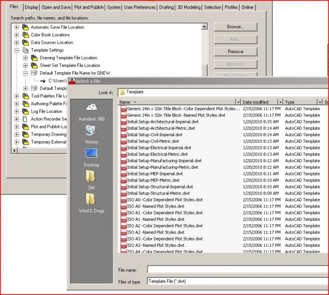

Dadgad Posted April 23, 2012 Posted April 23, 2012 Open your OPTIONS > FILES > TEMPLATE > then take a look at the attached image. What you are trying to do here, is determine which of the zillion different available templates is correct for your work. There are all different kinds. But the one thing that you really want to pay attention to, is whether the template is METRIC or IMPERIAL. If you want to work in METRIC then you can choose an ISO template, or any of the others which specifically say METRIC. In this way when you look at your scale lists, they will not be IMPERIAL (feet and inches) based. Once you have figured out the one you think is a good fit you can set that template by browsing through the template directory as shown, and specifying it as your QNEW template. If you ever want to use a different template you can access this template directory by selecting FILE > NEW and choose to open another one, or set a different one as your QNEW default. MSASU is absolutely right, you should create a drawing on this template including layer names, and settings, dimension styles, text styles, drawing sheet and block, and just about anything else that is frequently used in your work. In this way you can save this drawing (check it first) as a .DWT file, which means turn it into a template. Then you can reset this saved template as your new QNEW default, and then you can just go straight to work whenever you start a new drawing. I draw in mms, and so set my insertion and target drawing settings in USER PREFERENCES as unitless & unitless. I have tons of different templates, both for job and task specific needs. It is as simple as saving an existing .DWG as a .DWT file. This will save you tons of time, and make your work much more accurate. Another way to accomplish much of this would be through the use of .DWS (STANDARD files). They are also very simple to create, save any existing drawing as a .DWS file. I hope this helps. Quote

Dadgad Posted April 23, 2012 Posted April 23, 2012 It makes me nuts when I am working on a drawing which was created on an Imperial template, because all of the scale references and lists show default Imperial units of measure, even if the UNITS are set correctly. If you check in OPTIONS > USER PREFERENCES > DEFAULT SCALE LISTS it is very easy to determine what sort of template was used. That of course is much more difficult than just referencing any of the scale lists, which will display architectural scales. As a carpenter trained in the states, I am fine doing woodwork with Imperial measurements, I just don't want to have to use them and think that hard, unless I need to in Autocad. Quote
