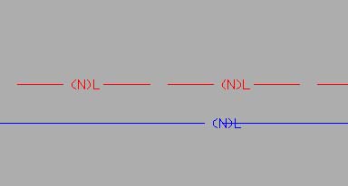

I wonder whether your two lines are actually using the SAME line definition. Your Linetype name is so long, you could get tired before you get to see the different characters at the end :shock:
I tried the linetypes, and they work. One linetype has a line of 0.5 units and a space of 0.2 units with letters that are 0.1 units high, and the other has a line of 30 units long and because there is no pen-up space after the letters, the next line starts in the middle of the text.
