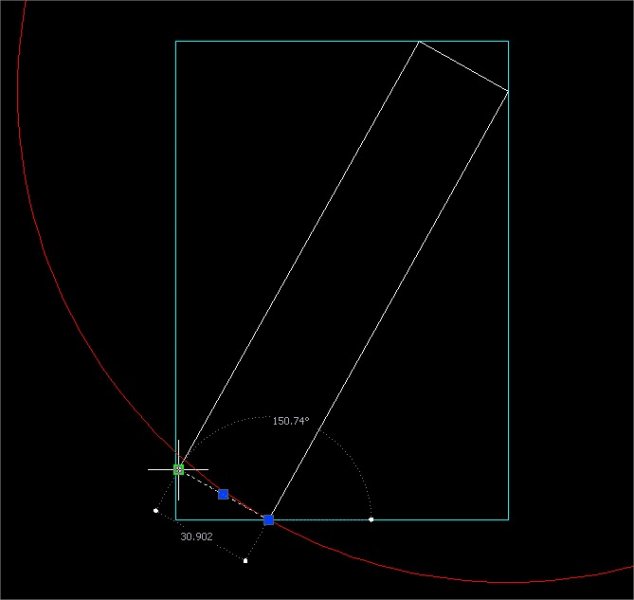

I have a rectangle that is 100 x 144 inches. I need to find out the longest rectangle that I can make from it.
So far, the longest and widest (widest?) that I've found is 147.75 x 30.9 inches. I must hold the 147.75 but I need it to be wider than 30.9 inches. What's the best way to do this?
Here's how I've been doing it:
I draw the block (100 x 144)
I make a circle with a radius of 147.75
I move the center of the circle in various places on the block and find the tangents of circle to block
I then make right angles and see what I've got
There must be a better way to do this.

Here is a screenshot of my progress.

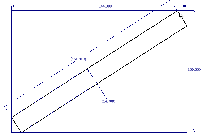

If you have access to a later version with parametric constraints.
Unfortunately the OP is using LT. bbankston: Isn't time to upgrade?

As I've stated the larger rectangle in the block must be 147.75 in length but how do I figure the width?

width is 31.292"
