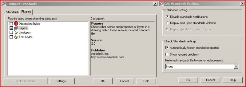

Using Standards doesn't have to be slow and can be used automatically, if set as shown in the image, save that I have not indicated the required .DWS reference.

Yes, that does make life easier. The only hassle I have with it is when there's a non-standard named layer (which I find constantly in our DWGs). Sometimes its something stupid like someone's used an underscore instead of a dash, or a space, or some twerp though a point might look nice. Or heaven forbid: CamelCase
Anyhow, from the OP I figure he's got lots of DWGs where he needs to change their layer properties to match one. I.e. some form of scripting would be the least time wastage, rather than opening a DWG, set it's standard & run the check, then open the next. I.e. layer states would be his best bet in a SCR and run it through ScriptPro/AutoScript/etc.
