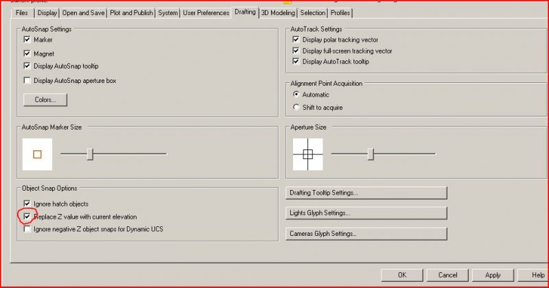

Dadgad Posted April 15, 2012 Share Posted April 15, 2012 You're welcome, glad it worked out. Often people who typically work in 2D are somewhat oblivious to the Z axis. When viewed in plan one cannot read elevations along the Z axis, but from any other perspective, with the exception of Bottom view, you will. It might be helpful to set your OBJECT SNAP OPTIONS on the DRAFTING tab of your OPTIONS 'to replace Z value with current elevation'. This will help to create drawings on one plane. An easier way to do the same thing is to enter OSNAPZ at your commandline, and change the setting from 0 to 1. The FLATTEN command is a good one to use before saving a completed drawing, as are PURGE and AUDIT. Quote Link to comment Share on other sites More sharing options...
