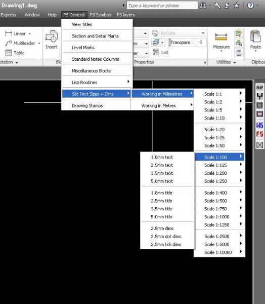

I've created a .cui file for my business unit, but I'm having an issue which I'm not sure how to solve.
I have created a pull down with text scales and dims scales, so depending on the scale of drawing you are using, you will always have a uniform text to use. (Annotative text can't be used due to client restrictions).
Now, I originally had the text set to romanS, but upon a discussion, we now need to use arial narrow. It looks better and takes up less room, apparently.
CAD doesn't have an SHX file for this, so I have used the Windows TTF and renamed it to arialn, as that is the system name for it, but when reloading the .cui with this simple text alteration, it has reduced all my custom icons to clouds with question marks, and will only give me text in arial, not arial narrow.

As eldon mentioned in the post above, maybe narrowing that so it 'acts' like ArialN will be the best course of action. I just want to double check with you guys though, if this is the correct way of writing it into the .CUI. I'll give you an example of part of it...
1.8mm text
^C^C_-style 1-8_1text arialn;\T1.05\W0.8;;;;;
I hope this is right!
OK...
I've solved the symbols not showing up on my pull downs, so that is no longer an issue, but I'm still having difficulties telling CAD how to change Arial to Arial Narrow. The above didn't work, and I'm not really that advanced in this kind of thing to know how to change all the text in CAD, especially when I have numerous scales for the text.
I have attached an image of what I'm trying to achieve. I really hope someone can help.

Have you created a text style with the name ArialN in your template?
For our menu, I changed the text size to be relative to the dimscale - "'textsize $M=$(*,$(getvar,DIMSCALE),2.5) "

Changing the font file extension (TTF to SHX), in my opinion, serves no useful purpose.
I didn't think that just putting in the TTF in CAD would work, as that extension is Windows specific. It didn't take any time to change it, and it has seemed to work, Barring the fact it doesn't like arial narrow.
T'is a problem that I can't solve, and it's starting to grate on me a little that a tool like AutoCAD can't tell the difference between Arial and Arial Narrow.
Arial is a "style name" which encompasses many variations called "families". Arial Narrow consists of at least four variations of the condensed style.
Did you just copy the font from somewhere else or did you actually install the font?
What OS are you using? What OS is your client using?
"I took the arialn.TTF and changed it to arialn.SHX" - Ah, there is your problem. TTF & SHX are different file formats in the same way that Word DOC is different from AutoCAD DWG. Rename the arial font & place it back into the Windows Fonts folder to re-register it with the operating system. You will probably have to restart AutoCAD to get it to recognise the Arial font.
The windows operating system shares out TTF files, while SHX is a hangover from the past when each application had to supply it's own font files.
Once the Arial font is up 'n running, create a new text style in AutoCAD (which can be named arialn); hopefully your routine will work. Good luck

How would I go about creating my own style?
Don't worry, I only copied the font. I didn't remove it from Windows! I rarely move anything, prefering to have copies of everything, just in case!
New styles are created via the Text Style dialog box. STYLE is the actual command.
Oh OK, Sorry, I didn't think you meant in CAD itself.
Okay dokey, I'll give it a shot, and see if it works when I run the routine.
