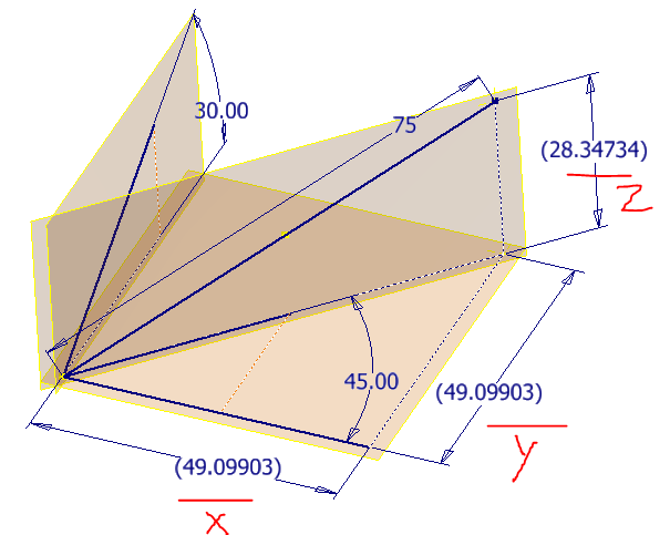

mamad0131 Posted April 5, 2012 Author Posted April 5, 2012 thx! i want to know how draw a line with first point and Angle from XY and XZ plane for example A(0,0,0) AB=40mm and Angle from XY=30 Angle from ZX=45 A member said with @40 Quote

SEANT Posted April 5, 2012 Posted April 5, 2012 We’re dealing with an interpretation problem, I think. AutoCAD’s standard spherical coordinate entry would commonly be phrased: From 5,5,0, extend a distance 75 mm at 45 degrees in the XYplane and 30 degrees from the XY plane. In AutoCAD, that line would be returned with the command sequence: Command: _line Specify first point: 5,5,0 Specify next point or [undo]: @75 I thought that was the request in the original post, though I probably misinterpreted your specification ‘Angle with vertical plane 30’. The wording in post #9 is different from post #1, but, to be honest, still a bit vague. Quote
mamad0131 Posted April 5, 2012 Author Posted April 5, 2012 i dont know why cant understand and my english is little so hard to say what is problem! yout sentence: From 5,5,0, extend a distance 75 mm at 45 degrees in the XYplane and 30 degrees from the XY plane. first i draw with first point (0,0,0) in XY plane with 45 degrees. it means degree between it and X and Y axis is 45. also the angle between this line and XZ plane is 45. now if i rise the end point until the angle between line and XY plane become 30! now the angle between our line and XZ plane isnt 45! it is more/less than 45! so i want draw a line to have particular angle FROM XZ and XY plane not as u said IN XY and FROM XY. Quote
SEANT Posted April 5, 2012 Posted April 5, 2012 Perhaps this is a better, see attached. fromXYfromXZ.dwgFetching info... Quote
eldon Posted April 5, 2012 Posted April 5, 2012 The projected angle into the XZ plane is 39.23°. But the vertical angle is drawn when looking normally to the line in the XY plane. Quote
mamad0131 Posted April 5, 2012 Author Posted April 5, 2012 SEANT said: Perhaps this is a better, see attached. That is exactly the thing i wanted! how did u draw it? i hope dont say @75 Quote
SEANT Posted April 5, 2012 Posted April 5, 2012 I intersected the cones on layers 30fromXY and 45fromXZ . Those layers are currently off. This could probably be done by trigonometry – if someone hasn’t posted a mathematical solution by tomorrow morning, I’ll give it a try. Quote

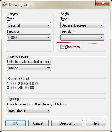

mamad0131 Posted April 6, 2012 Author Posted April 6, 2012 (edited) thx alot that is very usefull! i tried some lines all info was ok except front view angle for example true is 55 but it says 54.7 Edited April 6, 2012 by mamad0131 Quote

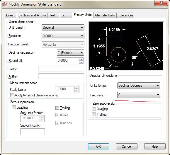

SEANT Posted April 6, 2012 Posted April 6, 2012 That 'true' reading may have been rounded. AutoCAD usually come preset to round angular dimensions to the nearest whole number. The properties can be reset for both document Units and Dimension via the two dialogs shown. If that is not the issue, upload that drawing. Quote
