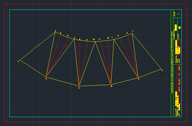

J-stone Posted June 30, 2014 Share Posted June 30, 2014 Well thank you ReMARK. So far, that makes the most sense. I don't get how I didn't notice that it appears to center on the points A, B, ect. Freaking awesome. now I have to lie down for awhile, rest assured, I shall tackle this today. And if anyone else has any input, it would be much appreciated. Quote Link to comment Share on other sites More sharing options...
J-stone Posted June 30, 2014 Share Posted June 30, 2014 Alright, I figured it out. Triangulating using the arc distance between the numbered points in the top view and the true length measurements. . . Example; take the arc distance between 10 & 11, draw a circle from point 10 as center with the radius of said arc distance. . . then draw a circle with the radius being the true length of line 11-B and a center of point B. . . now, where the two circles intersect, that is your point 11. I really hope that this helps somebody, as I know that I am not a vocal teacher, I teach the same way that I learn, by doing. . . thus, I am a spatial learner. Kudos to everyone on this site. . . for without this site, I would probably allow myself to lower my GPA just to be done with PF. Quote Link to comment Share on other sites More sharing options...

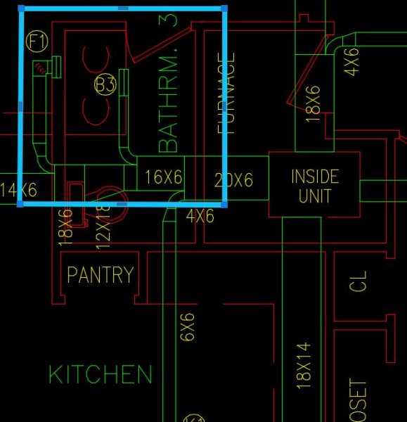

LANA211 Posted September 30, 2015 Share Posted September 30, 2015 Hi guys! Somebody working on plate HVAC elective , plate 1. I am stuck on the page 48. i Don't understand how to locate transaction piece from inside unite to the bathroom 3. If somebody can help me, please respond. Or somebody done that and have a screenshot to direct me, thank you!!!!! 054042.pdf Quote Link to comment Share on other sites More sharing options...
ReMark Posted September 30, 2015 Share Posted September 30, 2015 There are only 27 pages in the attached pdf. Is this the area you are referring to? Quote Link to comment Share on other sites More sharing options...
LANA211 Posted September 30, 2015 Share Posted September 30, 2015 No, elective HVAC, sorry i sent wrong one THis one ELECTIVE page 48 054044.pdf Quote Link to comment Share on other sites More sharing options...
ReMark Posted September 30, 2015 Share Posted September 30, 2015 Sorry, I don't have anything on that. Quote Link to comment Share on other sites More sharing options...
LANA211 Posted October 3, 2015 Share Posted October 3, 2015 ReMark! Do you have a full screenshot of this plate! Looks like is very similar what i am working on. Its will really helpful for me. I almost done that. Thank you so much Quote Link to comment Share on other sites More sharing options...
ReMark Posted October 3, 2015 Share Posted October 3, 2015 I would have to check my home CAD system. The image I posted earlier was made from a drawing I had on my work computer. I'm not sure I have the project you are working on. Quote Link to comment Share on other sites More sharing options...
LANA211 Posted October 3, 2015 Share Posted October 3, 2015 The duct and registers and similar. I will really appreciate if you can share with me this post. Regards, Svetlana Quote Link to comment Share on other sites More sharing options...

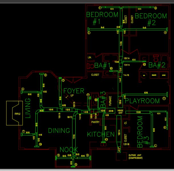

ReMark Posted October 3, 2015 Share Posted October 3, 2015 (edited) You'll have to give me a few minutes to fire up my CAD computer and have a look around. I'm on my laptop at the moment. I think I may have found the drawing. The title block says it is Project 9. Does that sound familiar? What exactly do you need to see? Is it the floor plan with all the ductwork? I hope this is what you were looking for. Edited October 3, 2015 by ReMark Quote Link to comment Share on other sites More sharing options...
LANA211 Posted October 3, 2015 Share Posted October 3, 2015 You'll have to give me a few minutes to fire up my CAD computer and have a look around. I'm on my laptop at the moment. I think I may have found the drawing. The title block says it is Project 9. Does that sound familiar? What exactly do you need to see? Is it the floor plan with all the ductwork? I hope this is what you were looking for. [ATTACH]55682[/ATTACH] Yes, it is project 9. Thank you so much for the attached drawing!!!! You the best ! Quote Link to comment Share on other sites More sharing options...

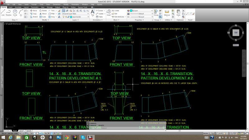

LANA211 Posted October 7, 2015 Share Posted October 7, 2015 Hi everyone! I'am doing project 9 HVAC 14x16x6, so far i think i am lost in numbers. ( So this is part of instruction if somebody done that. Can you help me guys put numbers on the right spot. Drafting HVAC patterns can be uncomplicated as long as you remember that there’s no single correct way to do it. To demonstrate this point, you’ll be drafting a 14 × 16 × 6 pattern in four different ways on Project Plate 3-2. (Note that this transition piece is 16″ long.) Remember that you need to show both a top view and a front view on your drawing of the ductwork. The top view shows what you would see if you were to look through the ductwork. Therefore, since this transition has four sides, you can simply let each side be the front view and draft a corresponding top view to set up the four pattern developments. On the upper half of Plate 3-2, place the two pattern developments in which the front views show the transition’s larger side. On the lower half of Plate 3-2, place the two pattern developments in which the front views show the transition’s narrow side. Draw all four pattern developments at realworld measurements. Follow the instructions listed here when drafting the top view and front view in the upper-left portion of the plate. 1. You’ll be showing the large side of the transition piece as the front view. Place the 16″ opening of the transition piece at the bottom, the 16″ side of the transition piece at the right, the 14″ opening at the top, and the slanted side of the transition piece at the left. (Keep in mind as you’re creating the development that the slanted side of the transition piece isn’t the same length as the straight side of the transition piece.) Drafting with AutoCAD Elective Project 56 2. Label the slanted side of the transition piece TL since this view shows the true length of that side in the front view. 3. Label the shape shown in the front view TRUE SHAPE. 4. For the top view in the upper-left portion of the plate, label the corners of the 14″ opening 1, 2, 3, and 4, beginning at the lower-right corner and continuing in a clockwise direction. 5. Also, in the top view, label the corners of the 16″ opening 5, 6, 7, and 8, beginning at the lower-right corner and continuing in a clockwise direction. The lower-right corner in this top view, therefore, will be labeled ″1,5″ since that single point in the top view represents a corner at each of the transition piece’s two openings. 6. Label the corners of the front view based on the points you numbered in the top view. Quote Link to comment Share on other sites More sharing options...

thekenbob1 Posted July 1, 2016 Share Posted July 1, 2016 Hi i also had a question about this project. On plate 4 of this they ask for you to draw a transition piece and nothing more. i feel like im missing something. like are they only asking fr the transition piece detail and thats all? Quote Link to comment Share on other sites More sharing options...
thekenbob1 Posted July 1, 2016 Share Posted July 1, 2016 Just to show you what i meen. Quote Link to comment Share on other sites More sharing options...
