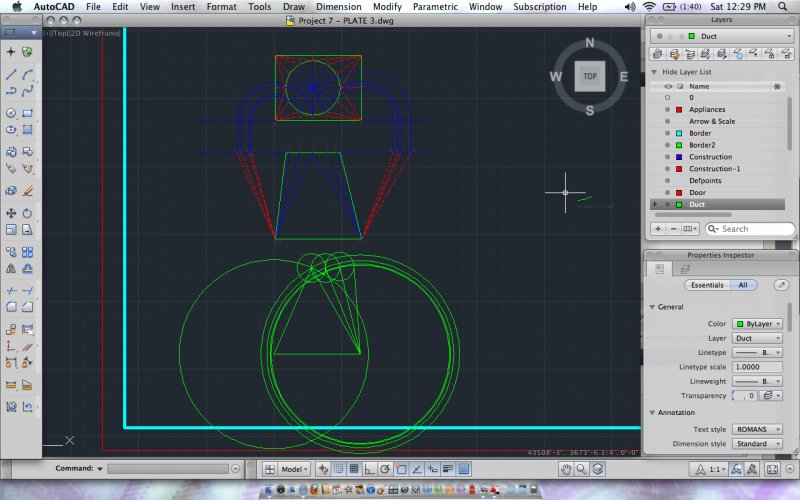

I think I followed the text correctly to find the true lengths. It's what to do next that I am stuck at. I think I have what you said correct now.

Oops, I just noticed that the circle is offset from center so B-10' is not equal to A-10'
Your circles don't look like perfect radius.
Don't type in the radius - use snap points.
Your next step will be to determine the length of arc from 10-9.
Not the cord length (many books miss this) you need the arc length.
Once you find this it is the same for all (9-8 is the same as 10-9).
Tip- you can find the arc length by
copy and paste pie shape away from the drawing.
trim the pie
list the arc
Draw circle of R 10-9 arc length at point 10' in your flat development..
Draw circle of R A-9' at point A
Where these two circle intersect is point 9' you now have line A-9

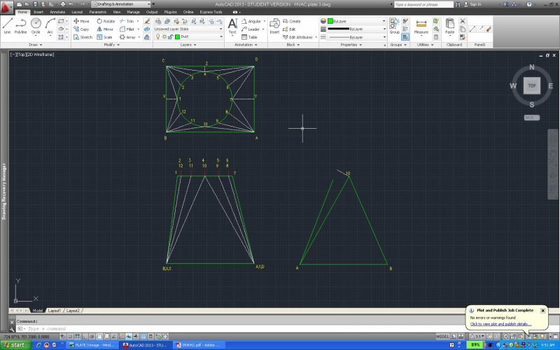

No, its not centered. Do I have this first stage correct?
I'm not at my CAD computer thus the reason for my question. Are you working on the Penn-Foster HVAC project?
Yes I am. I have seen the pictures of Plate 3 posted. It shows that the end result is supposed to be but not how to get there. I attached a picture of where I have reached. I assume I do the same thing on the left side but not sure what to do next on the right.

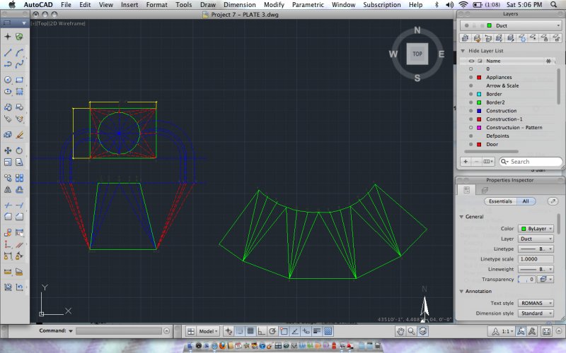

This is what I have come up with following instructions that I found online, though they were for a symmetrical piece. I know something is wrong as my arc on the inside isn't correctly meeting the lines for each point. However, I do not know what. Please help when able.
Project 7 - PLATE 3.dwg
It should be a spline curve - not an arc.

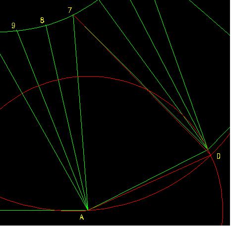

But you have point D in the wrong location.
Draw circle R A-D at A.
Draw circle R A-7 with center at 7 (A-7 and 7-D are same length).
Where these two circles intersect is the actual location of point D.

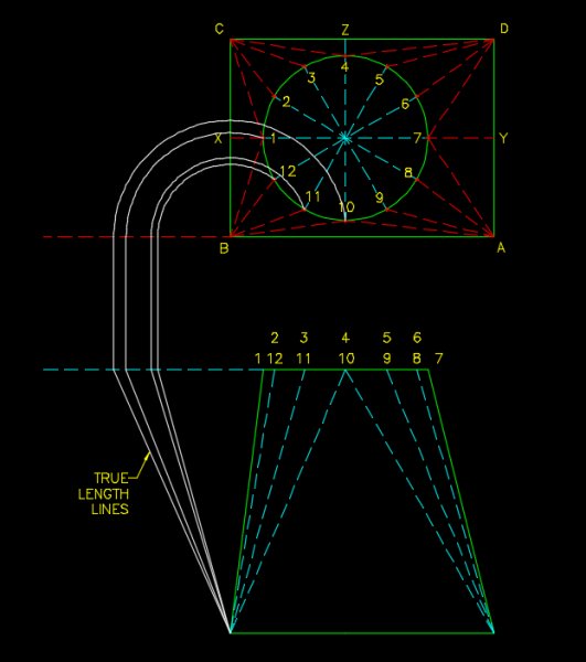

Hello, after reading through this thread, and others, I still do not know how to find the "true lengths". Once I understand something, then I know it forever, unfortunately I just don't get it. Please someone, spell it out in simple terms. Keep in mind I am an ex-framer, so not too bright :)
I guess my question is; how do I project the true length lines, how do I figure out what the radius is to project the lines out and down from my top view to my front view?
So how does one go about finding what the true length's are?
After looking at Car5858's drawing (in the thread I provided the link to) I think I know how the arcs are created. Draw circles using corner 'B' as the center through points 10, 11, 12 and 1 of the cylinder; trim as required. Like this...
