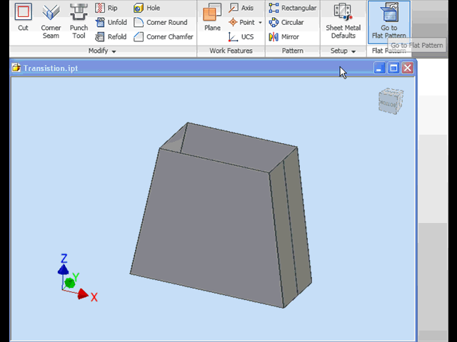

JD Mather Posted November 16, 2009 Posted November 16, 2009 I think if I were a student I would want to be learning next-generation CAD tools. http://www.autodesk.com/edcommunity Quote
Tankman Posted November 16, 2009 Posted November 16, 2009 I think if I were a student I would want to be learning next-generation CAD tools.http://www.autodesk.com/edcommunity Excellent post Mr. Mather! I'm from the very old school and have a tough time learning new "tricks." All my work in AutoCAD has been simple plan and elevation views; pipe, valves, pumps, chemical storage tanks. An add-on for AutoCAD draws all the pipe, fittings, valves, a great add-on! All are ANSI and the program will generate a BOM for me if needed. I believe John wanted a 10 x 14 base, a 6" x 6" top, elevation of 6". Perhaps you could post John's configuration if you are so inclined. If we had the technology 40+ years ago, life in the sheetmetal business certainly would have been easier. Quote
