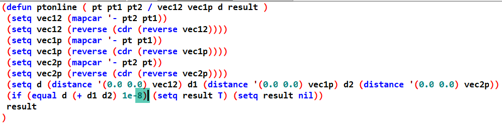

FINAL VERSION
(CAN BE APPLIED ON ENTITY WITH ARCS - MUCH FASTER THAN -BOUNDARY VERSION)
(defun rnd (/ modulus multiplier increment rand)
 (if (not seed)
   (setq seed (getvar "DATE"))
 (setq modulus    65536
       multiplier 25173
       increment  13849
       seed  (rem (+ (* multiplier seed) increment) modulus)
       rand     (/ seed modulus)
(defun GroupByNum ( lst n / r)
 (if lst
   (cons
     (reverse (repeat n (setq r (cons (car lst) r) lst (cdr lst)) r))
     (GroupByNum lst n)
(defun ptonline ( pt pt1 pt2 / vec12 vec1p d result )
 (setq vec12 (mapcar '- pt2 pt1))
 (setq vec12 (reverse (cdr (reverse vec12))))
 (setq vec1p (mapcar '- pt pt1))
 (setq vec1p (reverse (cdr (reverse vec1p))))
 (setq vec2p (mapcar '- pt2 pt))
 (setq vec2p (reverse (cdr (reverse vec2p))))
 (setq d (distance '(0.0 0.0) vec12) d1 (distance '(0.0 0.0) vec1p) d2 (distance '(0.0 0.0) vec2p))
 (if (equal d (+ d1 d2) 1e- (setq result T) (setq result nil))
 result
(defun ptinsideent ( pt ent / msp ptt xlin int k kk tst result )
 (vl-load-com)
 (setq msp (vla-get-modelspace (vla-get-activedocument (vlax-get-acad-object))))
 (setq ptt (vlax-curve-getclosestpointto ent pt))
 (setq xlin (vla-addxline msp (vlax-3d-point pt) (vlax-3d-point ptt)))
 (setq int (GroupByNum (vlax-invoke (if (eq (type ent) 'ENAME) (vlax-ename->vla-object ent)) 'intersectwith xlin acExtendBoth) 3))
 (setq int (vl-sort int '(lambda (a b) (< (vlax-curve-getparamatpoint xlin a) (vlax-curve-getparamatpoint xlin b)))))
 (setq k 0)
 (while (< (setq k (1+ k)) (length int))
   (if (and (eq (rem k 2) 1) (ptonline pt (nth (- k 1) int) (nth k int))) (setq tst (cons T tst)) (setq tst (cons nil tst)))
 (setq tst (reverse tst))
 (setq k 0)
 (mapcar '(lambda (x) (setq k (1+ k)) (if (eq x T) (setq kk k))) tst)
 (vla-delete xlin)
 (if kk
   (if (eq (rem kk 2) 1) (setq result T) (setq result nil))
   (setq result nil)
 result

The script is not working anymore on Autocad 2020. On LSP load I get: "error: malformed list on input".
this error message is usually caused by a missing ) or ( so maybe you cut-copy-pasted to much? Maybe download file again from original link.
13 hours ago, cupax said:
Hello.
Add this:
Edited by ronjonp
You mean after the 1e- ?
(if (equal d (+ d1 d2) 1e-) (setq result T) (setq result nil))
(I tested the version from the link provided by marko_ribar)
Note - you also need to change the "-" in "1e-" to a number of decimal places like "1e6". Otherwise it does not work.
Edited by pkenewell
oops... you're right pkenewell ... not sure how accurate it should be though , 1e-4 , 1e-8 or 1e-14... guess just a matter of trial and error. But good catch from both you and ronjonp 😀🧐
(if (equal d (+ d1 d2) 1e-4) (setq result T) (setq result nil))
Must be enough. ;)
(setq result (if (equal d (+ d1 d2) 1e-4) T nil))
The original would have been 1e-8 since all occurrences of "8)" were removed from all code posts across the forum when the forum software was "upgraded".
