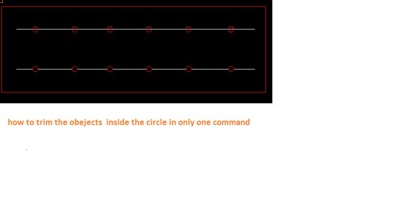

how trim many line inside multi circle on one step

trimming.jpgbut i am looking like this, i have attached a file please check

This seems to be deleting or trimming anything outside the circle, not inside the circle?
pra3389 Here is a version.
; assoc version
(defun test ( / ss x c1)
(setq ss (ssget (list (cons 0 "Circle"))))
(repeat (setq x (sslength ss))
(setq c1 (entget (ssname ss (setq x (- x 1)))))
(setq cenpt (assoc 10 c1))
(setq cenpt (list (nth 1 cenpt)(nth 2 cenpt) (nth 3 cenpt)))
(command "trim" (cdr (assoc -1 c1)) "" cenpt "")
) ; repeat
) ;defun
(test)
;vl version
(defun test2 ( / ss x c1)
(setq c1 (vlax-ename->vla-object (ssname ss (setq x (- x 1)))))
(setq cenpt (vlax-safearray->list (vlax-variant-value (vla-get-center c1))) )
(command "trim" (vlax-vla-object->ename c1) "" cenpt "")
) ; repeat
) ;defun
(test2)
