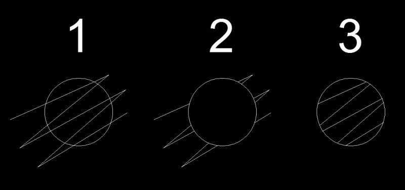

iam need lsp for trim or erase many lines inside many circle or block circle on one at one time

Let's say you start with what is shown in circle #1. What do you want the results of this custom lisp routine to look like after it is run? Circle #2 or #3?
thank you sir
i want lsp that when i select all circle in drawing automiticly trim or erase inside this circle as no.2 in your example
OK. By the way, that was done using the EXTRIM command. I only tried it on a single circle so I can't tell you, at this time, whether or not it would work on multiple circles.
Nope, that Express Tool is a lisp command, so you can't even call it from another lisp in multiple instances. Although the actual working function in that file is a normal defun requiring the ename and the point. So this might work:
(load "extrim.lsp")

This only works for circles, it's possible to extend for polylines as well - but more difficult.
Here is complete MEXTRIM.lsp... Thanks to Irneb, and my previous post for algorithm for randomize picking points inside closed entity I've managed to create complete MEXTRIM command...

This routine is resulting in everything outside of my circles being trimmed, leaving the portion of line inside as per #3 in ReMark's sketch above. Is there a setting that I could change for it to result in #2 in ReMark's sketch?

how to look like after it is run? Circle #3 (outside) ?
