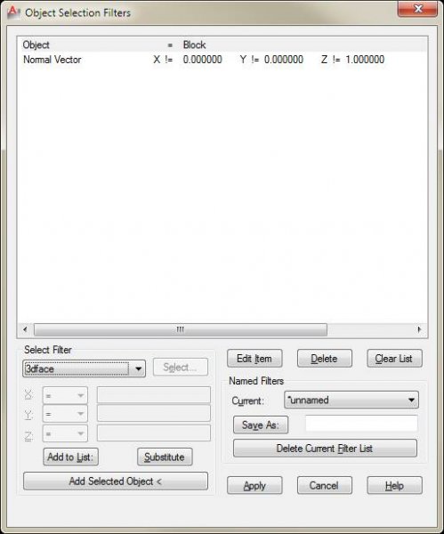

LeighJ Posted March 30, 2012 Posted March 30, 2012 Hi, For our bespoke AutoCAD plugin we can not use mirrored blocks or those with extrusions. I know I can find mirrored blocks by quick selecting scales of less than 0, is there a similar way to select blocks with a negative extrusion? Evem better would be a process (LisP?) to select all the blocks that are mirrored or have negative extrusions Thanks Quote

LeighJ Posted March 30, 2012 Author Posted March 30, 2012 This is a 2D drawing. Our plug in renders the drawing into a Java applet for web use. Mirrored blocks appear as rectangles rather than rendering. I fixe the neagtive blocks and sometime they still do not render. The only thing I can find at present is when I run a list command on them, they have a extusions, usually in the z direction, of -1, even though they are 2-d object. As an aside if you know how this occurs and can be avoided in the first place this would also be useful! leigh Quote

LeighJ Posted March 30, 2012 Author Posted March 30, 2012 Sorry, rendering maybe a bad word. Not 3d term here, just saying our plug in makes the drawing into a java applet. I don't believe the geometry has any elevation., the only thing differentbetween these blocks is that when I run list on them is the data "Extrusion direction relative to UCS:" with a negative value. I have attached an example. The only solution I have found is to manaully replace them (BLOCKREPLACE) retains this extrusion. I am hoping there is a quiker way to locate, and fix these. Example01.dwg Quote

SEANT Posted April 2, 2012 Posted April 2, 2012 The DXF group codes 210, 220, and 230 hold the components of the extrusion vector. I believe the vector is always normalized (i.e., a length = 1) so a mirrored block would likely be filtered if a routine targeted 230 !=1.0. To test the theory set up the FILTER dialog as shown. Does it correctly isolate the problem blockreferences? Quote
LeighJ Posted April 2, 2012 Author Posted April 2, 2012 SEANT, that is brilliant. Means I can find these easily now. Is there a way to edit those DXF group codes? Quote
SEANT Posted April 2, 2012 Posted April 2, 2012 Full bore editing does seem to be hampered. What values would you like to insert? Quote
LeighJ Posted April 2, 2012 Author Posted April 2, 2012 I would just like to be able to update all by blocks so these three values are 1, if there is a lisp or similar so I could do it with 1 click this would be perfect. Leigh Quote
SEANT Posted April 2, 2012 Posted April 2, 2012 There may be some routine available, I don’t know for certain. But, to clarify, which three values are in need of change? A standard WCS entity would have a Extrusion (Normal) vector of 0,0,1 I’ll assume everything in you drawing is coplanar to the WCS’s XY plane – just that some of the 2D references have erratic properties to get the correct 2D placement. If that is correct then I would suggest using that filter showed in my previous post to pre-select all references that are essentially “upside down”. Now, invoke the MIRROR3D command, choosing the “Delete original” option. Conceivably, you would also like to ensure all scale values are 1.0. Using a new Filter, or the Quick Select feature of the Properties Pallet, select all references that have scales not equal to 1.0. All three X, Y,Z scales can then be reset to 1 in the properties pallet. Unless the reference geometry is symmetrical, however, the item in question may change visually from their current orientation. Quote
LeighJ Posted April 2, 2012 Author Posted April 2, 2012 (edited) I just need to reset the Extrusion (Normal) vector to 0,0,1. Everything is co-planar and just has some erratic properties which screws up external processes we run on the CAD plans. How would I use the mirror3d? Currently the scale factors are all 1, and need to remain positive. Sorry if this are foolish questions. I don't do any 3d work, so this is all abit new to me. Edited April 3, 2012 by LeighJ Quote
SEANT Posted April 3, 2012 Posted April 3, 2012 Everything coplanar makes it a simple process. Use the filtering technique mentioned previously, and then start MIRROR3D. Due to the pre selection, only the upside down blocks will be mirrored. During the command prompts, choose the XY option, pick any arbitrary point on the WCS XP plane, choose YES to delete source object. The block reference will now have the correct Extrusion (Normal) direction, but will probably have a X scale of -1. Filter for that to reset to 1. Quote
LeighJ Posted April 3, 2012 Author Posted April 3, 2012 Hi Seant, that does it, thanks for your help. Quote
