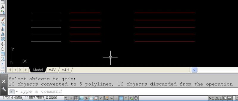

JOIN, select multiple lines, hit enter. That is all there is to it. Plines have to be touching at the endpoints, lines don't have to be.
Yes, I know that, but I still can't join those lines (not plines). The lines are collinear and here is the result. I only can join one by one line.
That's why asked to get explanation STEP BY STEP. Maybe I make some mistake.
[ATTACH=CONFIG]33963[/ATTACH][ATTACH=CONFIG]33963[/ATTACH]

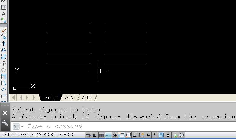

I don't have the option of joining mulitple lines in 2011. If it is new to 2013 try checking the new features workshop. Most of the new features are demonstrated with animations.
Personally I'd do what Dadgad was referring to with pline->m->join and explode the lines afterward.
Now that I see your example, that won't work with the Join command. I was imaging multiple lines coplanar, like breaking one line into 4 pieces.
You would need to use Pedit, Mulitple with fuzz set. Or use Change with Ortho set on.
You gave me an idea to touch the ends of lines and voila, the lines are joined, but they are now converted to plines.
Unfortunately, in most commonly cases the lines which I need to join are with gaps and I must join it one by one, same as before.
BTW, command JOIN has the same options in A2012 and A2013
