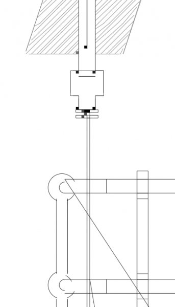

eleni07 Posted March 31, 2012 Author Share Posted March 31, 2012 @msasu I tried exporting to EPS but I get an error message and I can't open the file @remark Here is a printscreen of how part of my drawing looks on Autocad: http://s189.photobucket.com/albums/z270/eleni07__/?action=view¤t=Screenshot2012-03-31at40414AM.png and here is a link how it looks after I export it as a PDF: http://s189.photobucket.com/albums/z270/eleni07__/?action=view¤t=Screenshot2012-03-31at40414AM.png You can see the difference, and I also get these weird squares. It's driving me nuts. @SLW210 I am not using a third party program, I use the export command on Autocad. I must be doing something wrong :/ Quote Link to comment Share on other sites More sharing options...

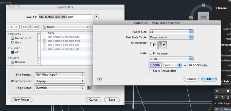

SLW210 Posted April 2, 2012 Share Posted April 2, 2012 Approved now. Until you have 10 posts all links need approval, this is to help reduce spammers. Why not just post directly to CADTutor? Select "Go Advanced" at lower right of reply box, then "Manage Attachments". How do you EXPORT to PDF? I do not have that option. You print to PDF in AutoCAD with the DWG to PDF.pc3 or an external PDF app. Quote Link to comment Share on other sites More sharing options...
ReMark Posted April 2, 2012 Share Posted April 2, 2012 There is no "export to pdf" option in the drop-down list for AutoCAD 2012. Quote Link to comment Share on other sites More sharing options...

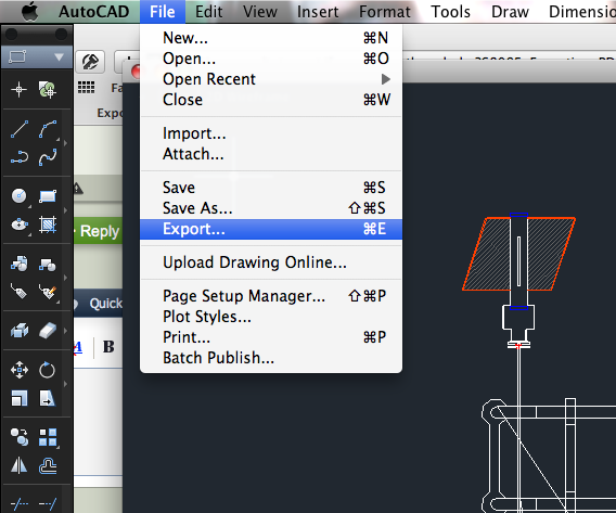

Dadgad Posted April 2, 2012 Share Posted April 2, 2012 There is no "export to pdf" option in the drop-down list for AutoCAD 2012. If you click on your upper left hand corner 'A' box you should find the EXPORT > PDF option, although I don't have it in my FILE drop down menu either. Quote Link to comment Share on other sites More sharing options...
ReMark Posted April 2, 2012 Share Posted April 2, 2012 The Export to PDF option doesn't give the user very much control over the final output unless you utilize the Page Setup Override. Quote Link to comment Share on other sites More sharing options...
SLW210 Posted April 2, 2012 Share Posted April 2, 2012 If you click on your upper left hand corner 'A' box you should find the EXPORT > PDF option, although I don't have it in my FILE drop down menu either. I seldom click the 'A'. As stated by Remark "The Export to PDF option doesn't give the user very much control over the final output unless you utilize the Page Setup Override." Try plotting to PDF and see if that works. Quote Link to comment Share on other sites More sharing options...
eleni07 Posted April 2, 2012 Author Share Posted April 2, 2012 I attached some printscreens showing the export method and the result. Try plotting to PDF and see if that works. Excuse my english, but when you say plotting you mean printing right? As I said before, I am not interested in printing it yet, I want to import it in photoshop and I would like for the lines to be in their place in order to work on top. If that makes sense. Thank you! Quote Link to comment Share on other sites More sharing options...

eleni07 Posted April 2, 2012 Author Share Posted April 2, 2012 Plotting the PDF was better but still not accurate. I get what you mean but as I have done this before, or I have seen other people do it I though there might be a reason, or something an doing wrong. Quote Link to comment Share on other sites More sharing options...
