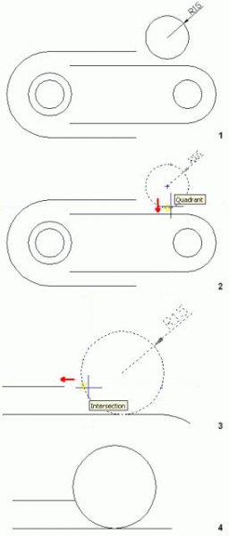

One solution: (1) draw the lines from right side a little longer and draw a circle of R15 in an arbitrary location; (2) move the said circle on the top line using his 4th (bottom) quadrant as base point; (3) move the circle to match the end point of right side line with the intersection of said line and the circle (select Intersection Osnap mode and pick the line, respectively the circle); (4) trim the unwanted parts.

this is how I would have done, but I still would have asked for more dimensions in an attempt to make sure i was getting it right lol

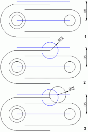

Second proposal: (1) do an offset to the horizontal axis at 35 units (20 + 15); (2) from the end of right side line draw a R15 circle; (3) draw a circle of R15 from the intersection of helper line and circle (blue entities); next just erase those helper lines and trim unwanted parts.

This is true, is the cursor that I have set to 100% - I will fix the picture. Thank you for notifying this.

I solved the problem in this way. I think this is the best solution.
