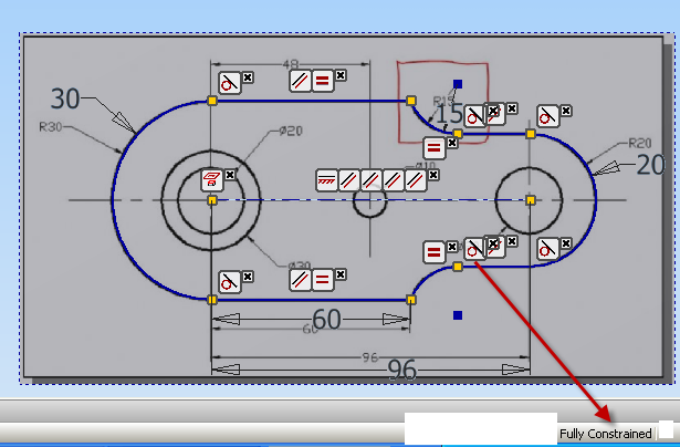

nkini Posted March 28, 2012 Posted March 28, 2012 Hello everyone, I am trying to figure out how do I create this arc which does not have centre point co-ordinates . Also not able to use any of the arc or circle features to create this highlighted arc. Any help is greatly appreciated. Thanks. Quote

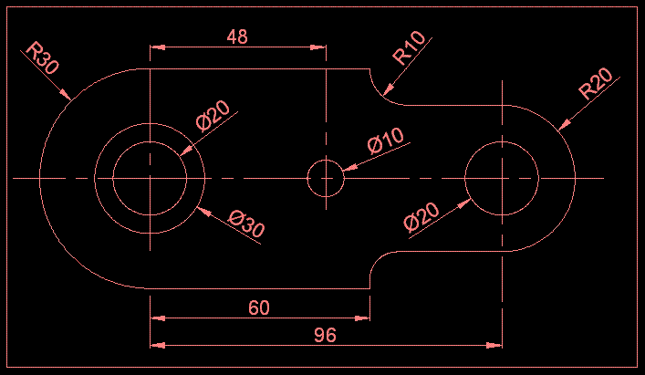

amir khan Posted March 28, 2012 Posted March 28, 2012 Here is the correct dimension picture u can see it Quote
nkini Posted March 28, 2012 Author Posted March 28, 2012 Thanks amir and Tiger. With the corrected picture and radius 10, fillet option would be best. The picture I had with Radius 15 was a bit hard to do. Quote
DANIEL Posted March 28, 2012 Posted March 28, 2012 Thanks amir and Tiger. With the corrected picture and radius 10, fillet option would be best. The picture I had with Radius 15 was a bit hard to do. It's because you needed more information, either the center of the radius or the length of that one straight section ..... Quote
nkini Posted March 28, 2012 Author Posted March 28, 2012 Yes Daniel. Totally agree with you. Thanks for clarifying my doubts. Quote
JD Mather Posted March 28, 2012 Posted March 28, 2012 Here is the correct dimension picture u can see it I think you changed the problem. I would not count that correct. Although there is a missing dimension in the original problem - you have changed a given dimension. Can't do that. Oops - I was wrong too. All the needed dimensions are there. Quote
RobDraw Posted March 28, 2012 Posted March 28, 2012 Actually all the information is there if you make the assumption that the R15 is tangent to the line extending from the R20. Quote
JD Mather Posted March 28, 2012 Posted March 28, 2012 Actually all the information is there if you make the assumption that the R15 is tangent to the line extending from the R20. Yep, you are right. Solving in a modern parametric CAD program shows that all the needed information is there. (I think it safe to assume tangency.) Quote

nkini Posted March 28, 2012 Author Posted March 28, 2012 Assuming tangency, if I were to use manual drafting techniques, I would create a construction line 35 units above centre as shown. With a compass measuring radius 15, I would move along the construction line until it touches point 1 and is a tangent at point 2. But AutoCad has no feature in it to complete this. I am sure it is possible on SolidWorks or other CAD programs. Quote
JD Mather Posted March 28, 2012 Posted March 28, 2012 But AutoCad has no feature in it to complete this... Sure it does. At least 2012 does. What release did they include parametric geometry constraints in AutoCAD? Quote
ReMark Posted March 28, 2012 Posted March 28, 2012 I believe they first appeared in the 2010 release. Quote
Dadgad Posted March 28, 2012 Posted March 28, 2012 I believe they first appeared in the 2010 release. That sounds right to me, they were definitely in by 2011. Quote

RobDraw Posted March 28, 2012 Posted March 28, 2012 That was obviously an assignment of some sort for a beginners course not some submittal. It is a challenge for a student with a brain. Draw this part with the given information. It took me less than 2 minutes to figure out that it could be done without using advanced software. Like SLW said, the lack of any other information logically leads you to tangency. Sometimes the obvious answer is the correct one. In industry, you have to spell everything out in order to avoid wrong assumptions such as the one Amir made by changing the radius to 10. Quote
JD Mather Posted March 28, 2012 Posted March 28, 2012 ... avoid wrong assumptions such as the one Amir made by changing the radius to 10. Ahh, but that dimension was already spelled out on the drawing. Fortunely the co-pilot on JetBlue was able to make independent decisions yesterday. The back on 9/11 passengers over Shankseville, Pa were able to..... ....comes down to what is the cost and likelyhood of making an incorrect decision based on the information avialable. I guess we should send this one back as the material thickness is not specified either. Quote
