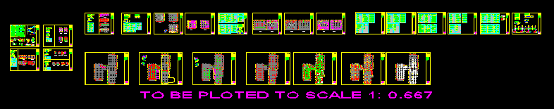

Some times comes a file has all the project drawings.
All frames on one layout (as attached)
So I wrote this simple lisp
