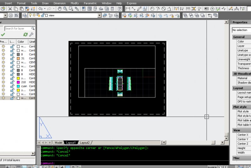

therealsaint01 Posted March 26, 2012 Share Posted March 26, 2012 Hi, I wonder if anyone could help me. I am battling to get rid of this grey background thing in the pic. I am trying to make it all blackwith NO page border things(dashed square). This effect is causing problems for me when i am trying to make view's in my layouts. I know its a type-in command-i just seem to have forgotten it.. Thanks ladies/Gents Quote Link to comment Share on other sites More sharing options...
MSasu Posted March 26, 2012 Share Posted March 26, 2012 Those were intended to help you visualize the page size and views placement on it. But if you want to get rid of them just go in Options --> Display --> Layout elements and un-check "Display printable area" and "Display paper background" options. Regards, Mircea Quote Link to comment Share on other sites More sharing options...

CyberAngel Posted March 26, 2012 Share Posted March 26, 2012 The solid outer line represents the edge of the paper. The dashed inner line represents the printable area inside that paper. You can remove the dashed line, but be advised that you may place things outside it that will not appear on your final print. Quote Link to comment Share on other sites More sharing options...
