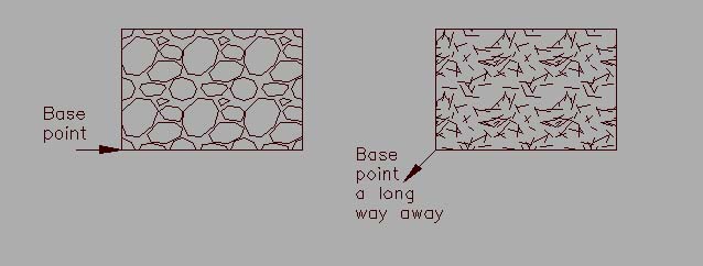

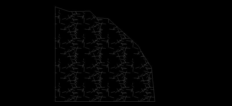

Hi its me again, I have problem for hatching the gravel, everytime i am using the hatch gravel it becomes like this as it shown on attached image, is there any problem on my setting? it is the same when i used concrete hatch. please advise me. thanks:)gravel hatch.jpg

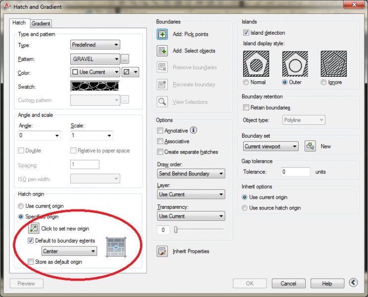

In Hatch dialog-box, set Origin to Center of Hatch area.

Hi Stefan BMR, thank you for your reply. I tried that setting but still the same problem? any option? Thanks
Try changing the scale of your hatch. I have the same thing happen to me once in a while, usually tweaking some of the settings sorts it out. Don't know why it happens though.
When I see this happen, I use the "click to set new origin" button and pick a spot in the center of the hatch area. You may have to do it more than once.
