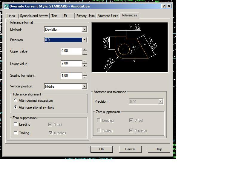

Beckyfonts Posted September 14, 2009 Share Posted September 14, 2009 how to set the lower limit only witout any upper limit? For example, the dimension is 350 mm and you want to set a lower limit of -2, how should that be done? sorry this may sound so basic but i need help Quote Link to comment Share on other sites More sharing options...
dbroada Posted September 14, 2009 Share Posted September 14, 2009 you do have an upper limit, it is 0. as Ako said above you either have deviation of +0/-2 or limits of 348/350. I ALWAYS prefer limits rather than deviation as you are not relying on somebody else doing the sums. One less thing to go wrong. Quote Link to comment Share on other sites More sharing options...

Beckyfonts Posted September 14, 2009 Share Posted September 14, 2009 ooppss... but the lower limit is 2 (-2mm) and the upper one is 0 in this case... no upper limit can be tolerated but a deviation of -2 below van be tolerated Quote Link to comment Share on other sites More sharing options...
dbroada Posted September 14, 2009 Share Posted September 14, 2009 set up as appropriate in your dim style dialogue Quote Link to comment Share on other sites More sharing options...

dbroada Posted September 14, 2009 Share Posted September 14, 2009 set PRECISION to 0.0 as in the screen shots above. you may need several dim styles so that different dimensions can have alternative settings. Once your styles are set up you can use the properties palette to apply the appropriate style to each dimension. Quote Link to comment Share on other sites More sharing options...
Beckyfonts Posted September 14, 2009 Share Posted September 14, 2009 Thanks Dave. I already set the Precision to 0.0 but still what comes out is a double decimal digit. What else can be wrong? I am so confused now, how come the computer does not follow. Was there a setting made earlier since this is a modified drawing ... drawn by someone else and I am asked to modify it. Sorry for this barrage of questions, but would really appreciate your help. I am new. Quote Link to comment Share on other sites More sharing options...

Beckyfonts Posted September 14, 2009 Share Posted September 14, 2009 Thanks a lot Dave for all the advices. Finally, 'did the limit and it's okay now. It helped to know that there is a forum avaialble where you can ask and be able to get immediate feedback. More power to this forum. Quote Link to comment Share on other sites More sharing options...
