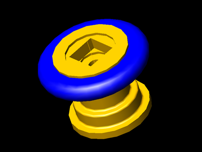

What would the be the best way to create a square counterbored hole in the center of this solid object.
Thanks for any suggestions

I've been trying to subtract a solid cube from the hole using Subtract but I can't seem to get it to work.
Any help?
Close. I want the top of the square counterbore to start at the top of the smaller diameter hole. In other words I want to counterbore the smaller diameter hole. Hope this makes sense.
It is just a matter of placing the cube you want to subtract. I didn't have any problem doing it.
What exactly is the problem you are having?
It seems to just add the cube to the object. It doesn't seem to actually subtract it.
bumper2.dwg
I just got it. What I was seeing was the original copy of the object.
Here you have it. You had 2 spools on top of each other. That's why it seem to be adding the cube. I removed one spool and then it all worked fine.
bumper3.dwg
Now I need to chamfer the edges of the square counterbore.
