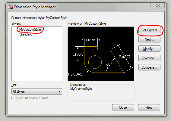

When I do any dimenison measure, the numbers are too small. How do i enlarge them?

I think you are trying to adjust the text height in your dimension style? If so follow the clues circled in red on the attachment. I have started this exercise from the DIMENSION toolbar, you could do the same from the RIBBON, or the commandline.

I would like to make specific changes to the DIMSTYLE and have them stay that way.
I start off with a Template I made called Net Draw Start. It has all of the colors, layers, line types, etc that I use in drawing nets and marine gear. I'd like to make a permanent DIMSTYLE for this template.
I can start off any drawing by modifying the current style, but when I close and save, the DIMSTYLE reverts back to the one AutoCAD 2012 started with... STANDARD.
I listed my 'new' style under the box that names the styles, but it still reverts back AFTER I close out and reopen.
Operator Error for sure........I am missing something in my proceedure .
Suggestions?
Thank you again.
Did you make your custom style "Current"?
Thank you both. That worked just fine.
