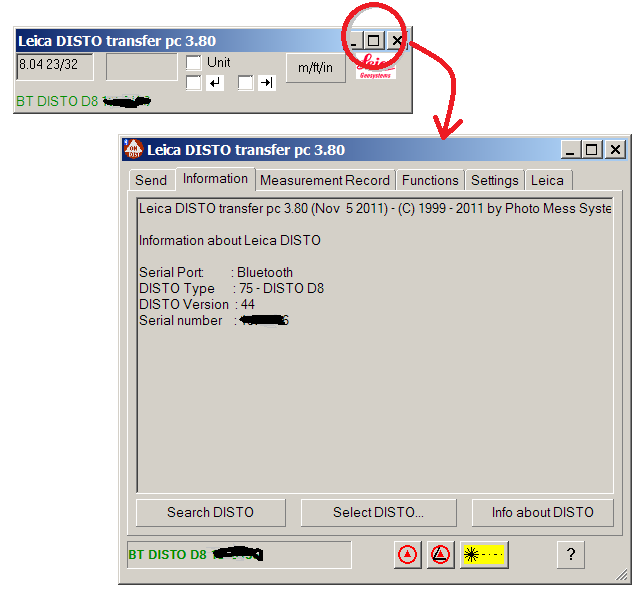

Hi all, trying to get my friends Leica Disto D8 to work with AutoCAD 2010 but for some reason it wont transfer measurements via Bluetooth - (and yes, Bluetooth is switched-on on both devices and paired etc). Does anyone have the same combo of laser measure and AutoCAD who have set it up without issue? The survey equipment company who sold the Disto D8 to him are closed on a Saturday / Sunday so I can't get any help there until Monday morning and he wanted to use the weekend to get to grips with it all before going out on site.
I have tried to follow the guide from the Leica website using the Disto Transfer software but without success :(

Pair the devices, start Disto Transfer PC, type LEICADISTO at the AutoCAD command line.
seems to connect fine as before but wont send the measurements. We're now starting to think its the USB Bluetooth receiver as it was a cheap £10 job and my friend says it stopped working with his mobile phone but he thought that was something he had done.
Does Leica Transfer PC start? Does it detect your Disto? Can you send measurements to Leica Transfer?
You are pressing the Bluetooth button on your D8 to send each measurement, right?
Edited by nestly
Problem solved! - it was a dodgy USB Bluetooth receiver. We have swapped it out and now everything works fine and dandy. :)
