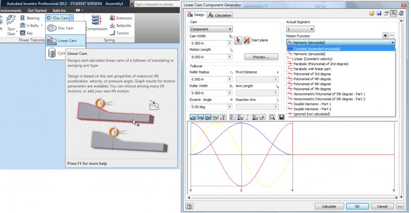

JD Mather Posted March 17, 2012 Posted March 17, 2012 dancedanceyo said: The purpose is to trace a board of wood with it and cut it out in the shape a ramp. I'm participating in a competition that requires a vehicle only powered by gravity If you are a student you can download Autodesk Inventor Professional for free from http://www.autodesk.com/edcommunity and Inventor will create the ramp for you based on any motion law you want. Quote
