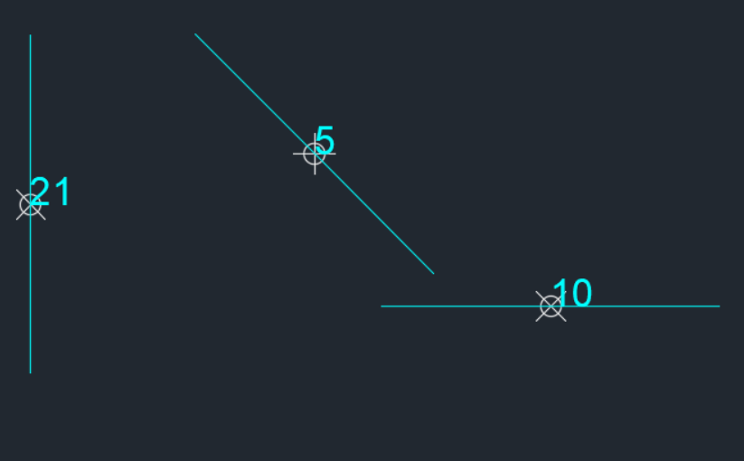

Hi, Lee
I am trying to achieve the same thing but I need to also move the blocks to the points
Do you have a lsp routine that do this by any chance?
Thank you.

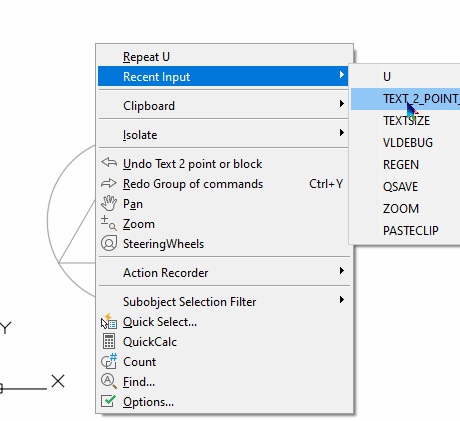

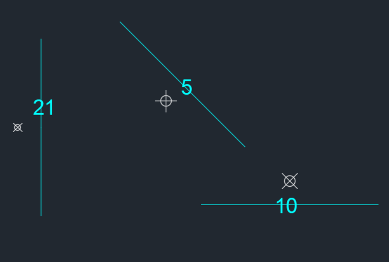

Another mod of the original code from Lee Mac (Thanks).
Comments in the header.
;; https://www.cadtutor.net/forum/topic/37515-moving-text-block-to-adjacent-point/?do=findComment&comment=566551
;; Text 2 Point  -  Lee Mac 2012
;; Prompts for a selection of Text and Point entities and moves
;; each Text entity to the nearest (2D distance) Point entity in the set.
;; Retains existing Text elevation.
;; MODIFICATIONS BY 3DWANNAB
;; Modified on 2022.11.18 by 3dwannab.
;;  - Added INSERT along with POINT to the selection.
;;  - Added undo handling.
;;  - Prompt to pick fuzz value.
;;  - Retain slection after the command.
;; Modified on 2022.12.09 by 3dwannab.
;;  - Added MTEXT to program.
;; Credit to Lee Mac for the original coede

Heey @Lee Mac,
First of all i am really a big fan of yours, you really help so much with your genius lisp solutions. I wish you always success.
I am wondering if your lisp can move texts and lines too, here is the case
Sample.dwgFetching info...
Edited by asdfgh
If you look into the command in VL lisp getclosestpointto that is the answer for this problem, just select the 3 objects, point, line & text. then based on the Line get the new point and move the text and object to the respective point.
The line with 10 may end up with the point on top of the 10.
Bit busy at moment will add to To do but some one else may jump in.
Edited by BIGAL
