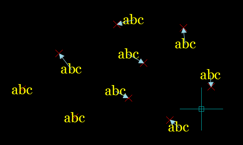

I use a very useful LISP by Pedro Ferreira called PMSFptwtxt which places a 3D point at the insertion point of a text string. It's great for processing point surveys which have been flattened, thus losing their elevation height.
Unfortunately the text label giving z-values for each point is usually not positioned correctly relative to the point which it describes, so the 3D points created are correct in z-value but not x and y. Most labels are consistently located (say top right) at a fixed distance from the point, but a few are below left or above centre etc. Having gone through labouriously finding and moving any rougue labels by eye, I started thinking there might be a more efficient way to acheive this.
If there was a recursive LISP that draws a line between the text insertion point and it's neighbouring point then I could filter the line lengths to find the atypical distances and fix these manually, then select the remaining labels and move them all together. The only tricky bit would be telling the LISP which point the text relates to. I'm guessing this could be done with some sort of delaunay/voronoi routine to find the nearest neighbour. I'm a LISP noob, so I'm not even sure if this is possible but any hints/opinions would be gratefully received...
Thanks in advance!
Tom
Why does the LISP have to be recursive?
Give this a try:
;; Text 2 Point  -  Lee Mac 2012
;; Prompts for a selection of Text and Point entities and moves
;; each Text entity to the nearest (2D distance) Point entity in the set.
;; Retains existing Text elevation.

It will prompt for a selection of Text and Point entities and move each Text entity to the nearest Point entity (nearest by 2D distance), unless a Point is already found with equal X/Y coords as the Text entity.
The program will retain the existing elevation of the Text entity.
Example:
It's probably not the most efficient routine, but I don't have time study a better algorithm.
Example:
[ATTACH]33660[/ATTACH]

Try this adaption of Lee's code. Minimally tested.
