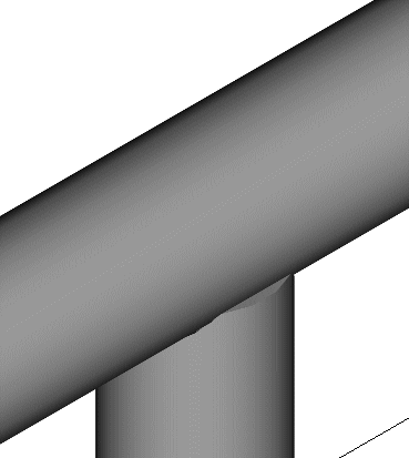

jamami Posted March 9, 2012 Posted March 9, 2012 Is there any way of dimensioning the radius of a cut out made on a 3D solid? The cut edge is not detected as a radius even when orthographic set at 90 deg to the cutting plane. Do I have to use solview/soldraw etc to create 2D versions of the view to dimension? I get the same issues when trying to dim wall thickness, overall widths of tubes etc. j a m a m i Quote

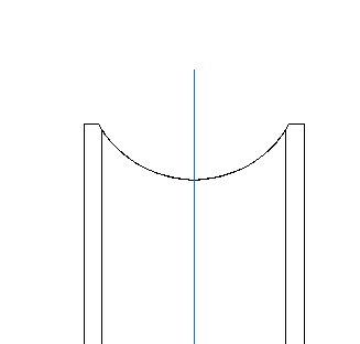

jamami Posted March 9, 2012 Author Posted March 9, 2012 I don't remember having any problems with dimensioning radius in 3D solids. I just tried it and it worked fine but I have no idea what your example looks like, how you arrived at the radius. Post a small sample of one that you can't dimension here so we can have a look. Hi rkent Heres one example, but it is the same with every time i try this 1/ draw 2 tubes 2/ subtract one from the other 3/ set up ortho view in paper space and try to dim radius - no luck. I think this maybe because it is only an apparent radius when viewed from one direction ie the radius of the tube which has been subtracted. i can get the above to work if i flatten the whole thing-but then lose dynamic updates when changed Quote
rkent Posted March 9, 2012 Posted March 9, 2012 Yeah, that isn't going to work, I have problems with Inventor on similar stuff so it isn't just AutoCAD. Quote
Dadgad Posted March 10, 2012 Posted March 10, 2012 That isn't a circular arc. The only way it will be a circular arc is when they intersect at 90 degrees. Quote
