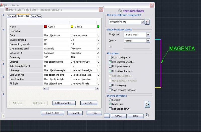

k_udhay Posted March 9, 2012 Author Posted March 9, 2012 now you are using the CTB option can you post a screen shot of it. Does it look like Tiger's? This is what I see now: Quote
ReMark Posted March 9, 2012 Posted March 9, 2012 See where it says Color....Use object color? Well that should be set to Black for ALL colors. Quote
MSasu Posted March 9, 2012 Posted March 9, 2012 Seems that your monocrome.ctb was altered. In the CTB edit window go in "Form View" tab and select all entries in colors list and under Properties --> Color select "Black". Or search on Internet for an unchanged monocrome.ctb file. Regards, Mircea Quote
