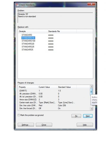

dear designer,
there is cad standard check where we insert .dws for checking layers,linetypes,text style,dimstyle etc.
but there is no cad standard checker for blocks.
i need some what like this lisp for check standard blocks.
thanks in advance.

there is standard checker in autocad. where we give command check. and add the standard.dws file which we have created for standards. which will cross check with standards in dws with my working file. like layers,line types,dimension style,text style,etc. but in this process the standard blocks are not checked.
i need to check even the blocks name before sending the files.where there might be more than 100 blocks.
your lisp was very useful but each time i should give the names of the block which will take more time. i was using previously using filter command to find the blocks. for seeing names i used a lisp. but there i get only the names if i am finding one by one it takes a lot time.
