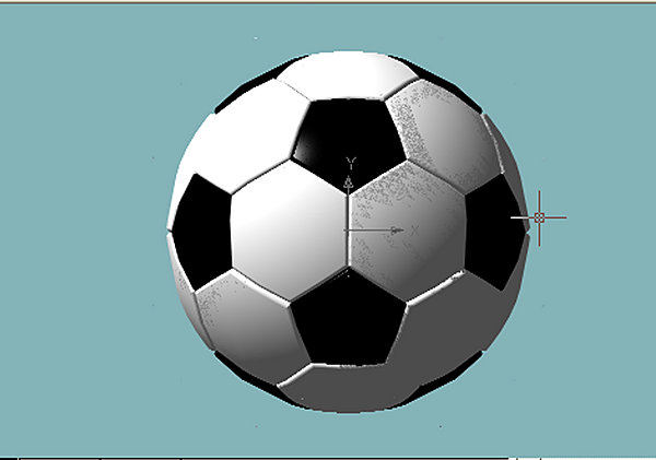

I mean, sheeeeeit LSR uda man. Ya can't get a better tutorial that that. Nuff said, nice football...................

jesus, the code does nothing, its poorly explained maybe unless your an expert in lisp and autocad and so far I didnt see anyone else manage to make another ball from it.
so just because someone posts a tutorial means everyone should try it out? lol :lol:
I can't run the Lisp file u supposed.
I don't know what it happened. when i load this lisp file into my obj,
it sign me unknown command. :( :huh:

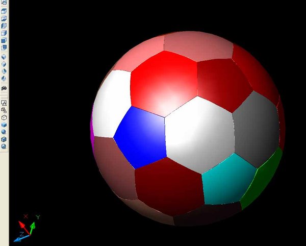

Gothic and Lasershows:
If you guys had followed or read the thread sequence you would notice that I posted
the wrong code (typo error) the first time, the two previous guys made the same mistake as you guys.
I corrected the code since then, the correct one is somewhere in the middle of the thread.
"X" made a glass like ball.
CarlB:
Simpler code. An excellent one, I like it. Yes, it only draws points not surfaces.
These points represent the vertices of the icosahedron which you create the surfaces.

I got only points. Why? Help me :(
you should read this topic fist page , the post of topic owner..
this is not for surface, soccer is only solid.
lisp file is only for coordinate points.
u should follow topic owner way.
