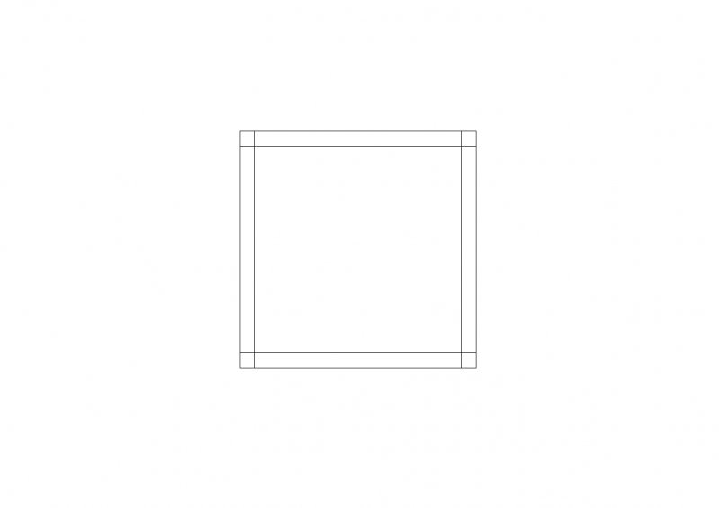

git_thailand Posted March 2, 2012 Posted March 2, 2012 (edited) Edited March 2, 2012 by git_thailand Quote
Tharwat Posted March 2, 2012 Posted March 2, 2012 That's not enough at all for all to guess what you are after , would you explain your aim a little bit more with extra details ? Quote
ReMark Posted March 2, 2012 Posted March 2, 2012 What are you considering to be the "symbol"? Is it just the circle with the "S" in the center? Quote

git_thailand Posted March 3, 2012 Author Posted March 3, 2012 (edited) What are you considering to be the "symbol"? Is it just the circle with the "S" in the center? yes. How To???? Edited March 4, 2012 by git_thailand Quote
ReMark Posted March 3, 2012 Posted March 3, 2012 He's asking for more information. Tell us exactly what you want and how you expect it to work. The more detail the better. Quote
fixo Posted March 3, 2012 Posted March 3, 2012 yes. How To???? If you can't explain try machine translator: http://translation2.paralink.com/translation.asp?lang=th Wll be good as well to upload your sample drawing with block Just a hint ~'J'~ Quote

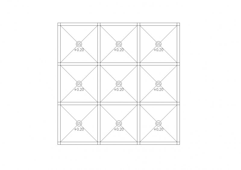

git_thailand Posted March 4, 2012 Author Posted March 4, 2012 need lisp for draw slab symbol (pic.2) Quote

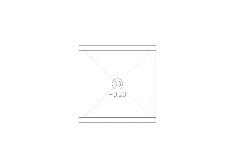

eldon Posted March 4, 2012 Posted March 4, 2012 I think the OP's need is quite simple. He/she needs a lisp which will, when a point is picked in a square area, draw the diagonal lines which will be broken at the centre by a circle, within which are the letters GS, and below which is a relative level +0.20. Simple really, but those who write these lisps need to know whether the areas are always square or rectangular, whether the letters are always GS, and whether the relative level is always +0.20. If not, how are the alterations coped with, etc., etc. To my mind, once one space has been filled in with the requisite lines and text, then copy could do everything needed, but not quite so classy as a special lisp written for a single use. Best of luck, I hope someone can give you some pointers on how to write your own lisp. Quote
ReMark Posted March 4, 2012 Posted March 4, 2012 Might also want to know text size for those letters too right? Will the lisp be required to create the layer the symbol goes on if the layer does not exist? What linetype will be used? Quote
nestly Posted March 4, 2012 Posted March 4, 2012 I envision pretty much the same thing as eldon. It's more than "one click" but a dynamic block could work as an alternative to lisp. The letters and level could be attributes if they're not fixed text/symbols. Quote
asos2000 Posted March 5, 2012 Posted March 5, 2012 I think that he need a symbol of slab thickness, level and crossing lines Its better to be a DB as attached SlabSymbol.dwg Quote
git_thailand Posted March 5, 2012 Author Posted March 5, 2012 i need lisp for a symbol of slab thickness, level and crossing lines Quote
Tiger Posted March 5, 2012 Posted March 5, 2012 i need lisp for a symbol of slab thickness, level and crossing lines Several people look like they are ready to help you but they need more information. See post #11 by eldon as to what information (to start with) that you need to provide. Quote
git_thailand Posted March 5, 2012 Author Posted March 5, 2012 (edited) more detail before - pick in boundary after - text height 0.20 (_layer S-SPEC-TEXT) - circle dia. 0.45 (_layer S-SPEC-SLAB) - cross line (_layer S-SPEC-SLAB) - units = meters sorry!! i no english man. Edited March 5, 2012 by git_thailand Quote
git_thailand Posted March 5, 2012 Author Posted March 5, 2012 I envision pretty much the same thing as eldon. It's more than "one click" but a dynamic block could work as an alternative to lisp. The letters and level could be attributes if they're not fixed text/symbols. text not move Quote
BIGAL Posted March 6, 2012 Posted March 6, 2012 This question could do way more in regards to the slab detailling it should be pick outside pline then all done including stuff like trimming crossing beam lines and edge beams. What about not square shapes ie true rectangle lines are not at 45. 1st Question should be, does shape meet rib spacing rules 3 or 4 to be created. I can see extra request after first go so write a broader answer maybe now. What happens when slabs are not square have rounded edges speak from experience. I think going back to first principles using block with x y scales may be helpfull and work on the L & W rather than seperate panel. Quote
