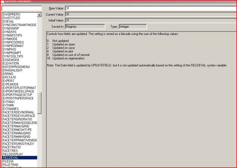

This screenshot should get you headed in the right direction. I have inserted a block into the MTEXT object ELEVATION, and defined the reference path for the field to the center of the circle in the ELEVATION SYMBOL. Then I used WBLOCK to create a block of the various bits. When you insert this block into a drawing it should be exploded. If you use it on a tool palette, then in the icon properties it should be set to explode upon insertion, which essentially activates the field, so that it will read the Y axis value of the center of the circle. If you copy it around your drawing, it appears to not be working, but depending upon your FIELDEVAL setting, it will display the updated field value after a regen, save, or whatever. Or you can double click into the field, and in the right click menu select UPDATE FIELD.
You should probably check your FIELDEVAL setting, and ensure that your variable is set to suit your needs, should it be set to ZERO it will not update automatically!
