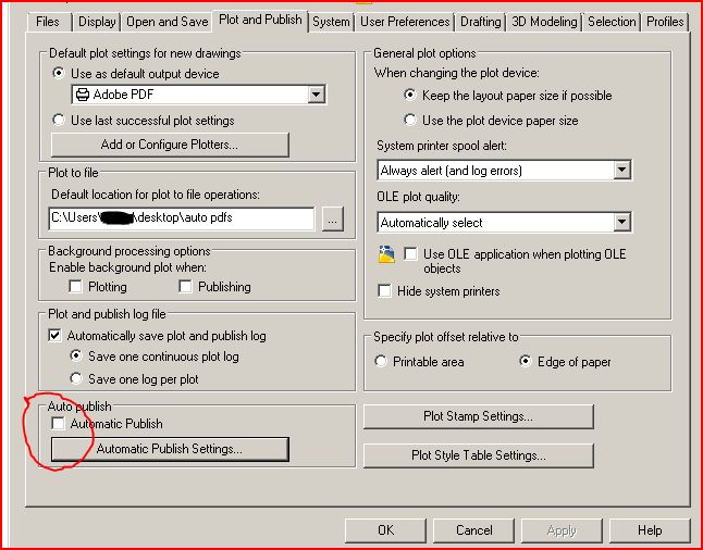

Do you have AUTOPUBLISH turned on, right click in your commandline to access OPTIONS and look at your PLOT & PUBLISH tab settings. If you have it checked, uncheck it.
No that one is unchecked.
Further up though 'enable background plot when': Publishing is checked
as well as 'auto.. Save plot and publish... As well 'save one continuous plot log'
