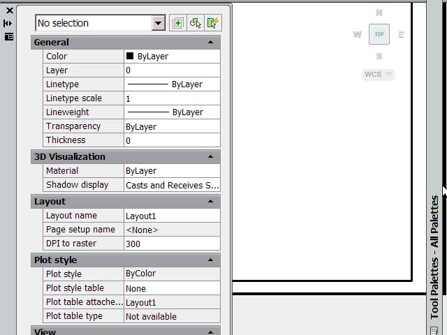

Thanks for the hi-tech response. Sorry I should have been a little clearer. I didn't mean that the scale itself was too small, I meant the actual size of the bar (once inserted) was tiny. i.e. say for example I was putting the scale bar under a door measuring 3'0" in width. The scale bar was about 1/100th of the size of the door.
I know how to increase the size of the scale bar to make it visible on the page (i.e. scale X or scale Y), but I wasn't sure that if I did this - I was mucking up the actual reference scale? Does that make sense? Sorry - hard to explain when you're talking abot two scales at the same time.

An Imperial scale bar from the Tool Palette should come in at 2" long. If it's actually "100x" smaller than your door opening, then either the door isn't really 36" wide, or the INSUNITS aren't inches.
Cheers for that - yeah that's the problem alright. The drawing is in feet and anything throughout the course of draughting the plan (that I've tried to inserty) has been in inches. I've gone into the properties of the item and seen that it was in inches, but it doesn't allow you to change this measurement/scale setting in properties? When I type the command INSUNITS, it only allows me to enter a vaule (i.e. 1, 2, etc.) not change the measurement setting.
My only problem now is - I have changed the scale factor of X, Y of the scale bar to 25, so it's a decent size to see on the layout page. Then from the little blue drop-down arrow (on the scale bar), I can change the scale from 1:1, to 1:10 or whatever. Final question is: let's say I leave the scale as 1" = 2'0", how do I know for sure that 4'0" on the scale bar really is 4'0" on my drawing?

"1" is inches, "2" is feet, "3" is miles, "4" is millimeters etc etc.... but that's too cryptic, instead use the dialog box for UNITS, where you can set INSUNITS from a dropdown list. For Imperial Architectural drawings, always use Inches. In fact, if you try to use anything else, AutoCAD will warn you....
Regarding the size of the Scale Bar. If you insert it with the proper INSUNITS, it will be right, ie it will correct for 1" = 1'-0" If you change the scale with the blue arrow to 1" = 2'-0" then you have to make the scalebar twice as large, which you do by changing it's scale with the properties palette. If want the scalebar to represent 1" = 10'-0" with the blue arrow, then you have to make the scalebar 12x larger, again done with the properties palette. If in doubt, measure or dimension the scalebar to verify that it's display matches it's actual measurement.
