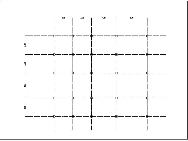

help !! lisp code for quick dimension&column
need code 1. auto column on grid line intersection (in layer column) pic. 1

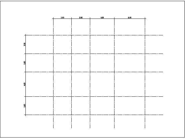

need code 2. select grid for auto dimension (in layer dimension) pic. 2

You may try the QDIM build-in command.
Regards,
Mircea

lee mac. i nedd example this fuctions
Regards,
Mircea

and how to auto column ???
Thank you.
how about just a simple ARRAY?
Did you read & understand what my functions are doing?
Think about how you would insert the Columns manually, and consider the functions 'foreach' and 'command'
