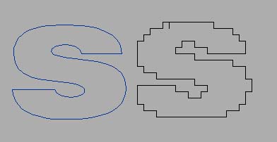

nestly Posted February 27, 2012 Posted February 27, 2012 I tried a couple different things, and I'm not confident any will actually help. I'm probably out of ideas, hopefully ReMark, or one of the others that are more familiar with splines can help resolve your problem. Splines to 2D Polylines with PEDIT Splines to 2D Polylines with PEDIT, then to Lightweight polylines with CONVERTPOLY Splines and 3D Polylines to 2D Polylines with FLATTEN (I had poor results) I'm not really sure what to do with the "ISP2" part, those are 3D Polylines and neither PEDIT nor CONVERTPOLY work. new block-nestly.dwg Quote
eldon Posted February 27, 2012 Posted February 27, 2012 I tried the R12DXF route, and then Weeded some of the vertexes. Here is my result Splat-Mk2.dwg Quote

ReMark Posted February 28, 2012 Posted February 28, 2012 I took a long look at what I created yesterday and I have to admit that I failed. The resultant geometry after the splines were flattened is terrible. My apologies. Quote
Dadgad Posted February 28, 2012 Posted February 28, 2012 I took a long look at what I created yesterday and I have to admit that I failed. The resultant geometry after the splines were flattened is terrible. My apologies. The FLATTEN command is terrible for complex curves, shockingly bad. Quote
ReMark Posted February 28, 2012 Posted February 28, 2012 As I just found out. It might just be better tracing the letters using a polyline. Quote
eldon Posted February 28, 2012 Posted February 28, 2012 Flatten does seem to behave differently if you opt for Hidden Line removal or not. Quote
SLW210 Posted February 28, 2012 Posted February 28, 2012 (edited) I'm not really sure what to do with the "ISP²" part, those are 3D Polylines and neither PEDIT nor CONVERTPOLY work. I had fair results using the Boundary command, though the S and ² act very strange, no matter what. I exploded every thing till nothing left to explode, ran overkill a few times then PEDIT>M>Join until ended up with quite a large fuzz factor (10000). The white is the BOUNDARY results. Edited February 28, 2012 by SLW210 Quote
