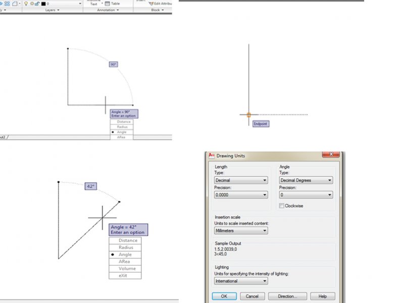

helpme Posted February 24, 2012 Posted February 24, 2012 hi all please help me i really cant understand the angle measurement in autocad if i draw 2 line in 90 deg and click on rotate tool chose one line end point and if i type 48 degree the line move but when i check the angle it says 44 whyyy can some help me in this please Quote

helpme Posted February 25, 2012 Author Posted February 25, 2012 here is the image file please see this and third image i typed 48 deg but it shows 42. this is what confusing me i use rotate comand and chose the end point of the line. Quote
eldon Posted February 25, 2012 Posted February 25, 2012 I am not sure why you are confused. The screen shots show the angle between two lines, not the angle that has been turned. If you have two lines at an angle of 90°, and rotate one line by 48°, then the angle now between the lines is (90° - 48°) = 42° Quote
helpme Posted February 25, 2012 Author Posted February 25, 2012 ohhhhhhh so how exactly does it works what if i want 48deg what should i do Quote
ReMark Posted February 25, 2012 Posted February 25, 2012 What if you want the angle between the two lines to be 48 deg? 90 minus 42 = what? Quote

eldon Posted February 25, 2012 Posted February 25, 2012 Perhaps you should start by drawing one line. Then you could rotate a copy of that line by 48°, and then you have two lines at an angle of 48° Quote
