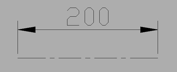

eldon Posted February 23, 2012 Posted February 23, 2012 How long is your line? This is a picture of a line 200 long, linetype Centre, metric units, LTSCALE = 1 Quote
