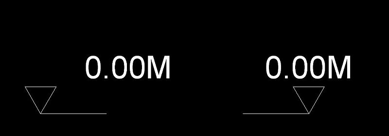

I have made the text in the attribute multi-lined because sometimes I want to add a second line of text. Now if you go to edit the block and type in the second line it all look good but if you OK it both bits of text appear on the same line :(
What am I doing wrong?
I tried to post it but it was too big.
Problem # 2
When I mirror the block the text goes off to one side? ? I have tried with the text locked and unlocked and it still doesn't stay central.
Does anyone use multiline text in an ATTRIBUTE?
Rarely for me, I use em only for single line texts.
For problem number 2 on your post, are you using a FLIP action/parameter?
or is it a direct mirror command
Direct Mirror command. Do you think it would be best with a FLIP Parameter?
For blocks Yes, coz you can specify the exact mirror line in which the line would flip. lookin at the picture you posted try putting the flip line the second zero. this would flip the lines on its supposed to be mirror position
