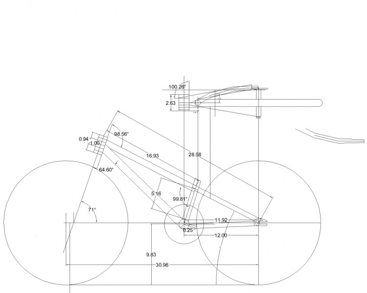

ggodwin Posted February 22, 2012 Posted February 22, 2012 Guy's I am fabricating some race bicycles and want to make my drawing's look as real as possible. I need to be able to draw the curves where the weld lines will be. Do you know if Auto Cad has any special tool that will draw these for me? Something like this Thanks in advance. Quote
paulmcz Posted February 22, 2012 Posted February 22, 2012 You are out of luck with Autocad LT. Otherwise, draw it in 3D and make a flatshot of your joint. Quote
ReMark Posted February 22, 2012 Posted February 22, 2012 Or fudge it using an ellipse. Depends on whether this is just for looks or for accuracy. You're going to do this in 3D eventually aren't you? Quote

ggodwin Posted February 22, 2012 Author Posted February 22, 2012 Yes, my 10 year old son, My 4 year old daughter and two customers. I have to have them ready by the spring season. Just basic 2D lines. I dont need the mitre's but recently saw another frame drawing and liked the look. Also, the more real the design looks the more problems I can detect. (Hopefully) Here is the last one I did. I just need a drawing to set my jig up. But, would like to have a drawing that looks like the final product. Quote
