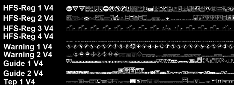

BIGAL Posted November 3, 2022 Posted November 3, 2022 Tombu you would like this, 100's of signs at your fingertips and its a TTF. So can use in say Word and Excel also. Now the bad news I can not find the company that made them "AUS Fonts" if you find them let me know. 1 Quote

tombu Posted November 3, 2022 Posted November 3, 2022 5 hours ago, BIGAL said: Tombu you would like this, 100's of signs at your fingertips and its a TTF. So can use in say Word and Excel also. Now the bad news I can not find the company that made them "AUS Fonts" if you find them let me know. I've attached the sign block drawing I use from Florida Dept. of Transportation. I'd like to see the one you have to see if I'm missing any. I might be able to find those fonts. If you have an image displaying text in an unknown font paste it into https://www.fontsquirrel.com/matcherator?token=ohd8q2l7ylb75dti to identify it. 164223165_mutcd-StandardFonts.zip Quote
